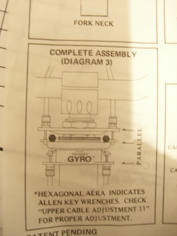

I have a Gyro.. and it won t work properly too.
but the system cable is diferente from ACS.
does someone have pictures from a Gyro system fitted, just to see the height of the stem, and if I have to put some spacer in the headset?
regards,
fLAVIO
Here you go Flavio
