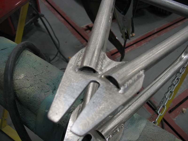

Any way my rear drop outs are crushed and mis shaped on my Redline that i am building, i have seen this repaired on other threads, i was just wondering if there was a specific way in wich this had to be done due to the Cro Mo Frame?

i just used a mig welder to repair these drop outs and it worked fine i just built up area with weld then ground and filed drop outs back to shape;)

that looks like a top job to be honest, i just wish my welding was as good as that lol
