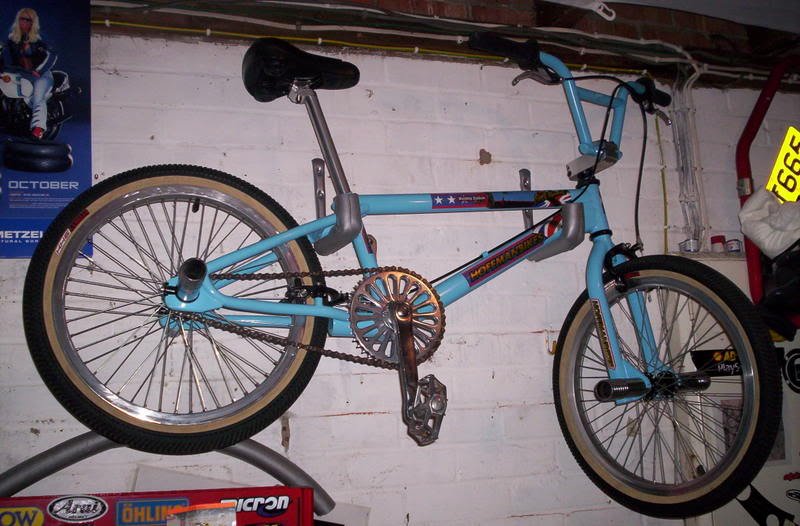

heres my hoffman condor i sprayed with halfords rattle cans and it came out superb
a lot of prep and patience but woth it imo
Re: Spraying DIY
« Reply #9 on: January 22, 2008, 07:43 PM »
That is lovely mate! Ok i'm quite confident now that I won't fook up these bars, thanks for all your advice guys  :daumenhoch:
