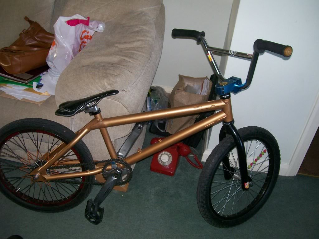

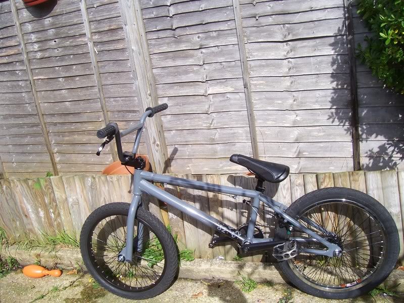

its all about being a fashion victom, and snobery perry  ;)  take me you cant sell dk's for love or money on here, yet im on my second dk bnow, i loved my first and it worked great, full cr-mo frame, not the lightest but then you change bits as you go along, funny aswell, if i changed the paint on my 4pack and added different decals who these days would know the difference  :LolLolLolLol: heres mine personalised  ;) im into riding not what the neighbours got  :)

 :) Hey Zed,it`s not all about the snobbery-well not for me anyway,just thought about trying something new.DK`s are great.I`ve ran their Chopstix cranks before and they were great,inexpensive,light and never broke.Fashions come & go,but a good bike lasts for ever!

wasnt getting at you mate the saint stuff is sweet,   :4_17_5: just what perry said about similar stuff that is as good but cheaper, and not got the right name on,  :daumenhoch:  its all about budget and what works for you  :daumenhoch:
