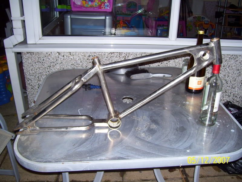

I just laid my hands on a 1979 cali mongoose f/f and was thinking about what wheels to put on it when i get round to it....  ::)
 :LolLolLolLol: still not completed general lees ripper...85% there.
The frame type has solid rear drop outs & has seen  some chain rub action in the pass from the wrong wheel fitment ...but its been repaired 2 a good standard.  :)
It has round tubing as all the oldest goose had, all the way down till it meets the drop out.
There is no coaster plate just incase some1 asks.
I tried my mrk 2 skyway graphites on the old girl but they will rub like mad :-\ so there not an option  :tickedoff:
What hubs\wheel set will fit ??

Would be good to see some pictures of it.  As Matt says the 'Cali' Mongooses didn't come out until mid-80's.
As for wheels for the Motomag mongooses here are the wheels on my 1978 Mongoose DeCoster.

My 1980 motomag had the rub too.
Running Tuff I's ok. On the 2nd pic of the coaster you can see the rub on the drive side seat stay - it was very common on this frame - the Team version had a flattened stay at the drop out to help the problem.

my 81 motomag had freewheel rub aswell as chainring rub
My bad Paul !  :-[ , Tuff I's are cool too  ;)

I have chain rub on my DeCoster also.
