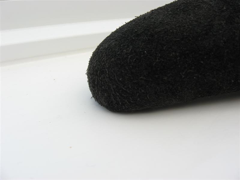

I sold my nos kashi 5gold suede seat, coz i wanted a crack at making my own.
So with the 5gold money banked i bought a rough Kashi MX seat for £2.
Bought a suede handbag off ecrotch for £2, carpet fitters glue £2.70 and £3 for the decals.
Stick a seatpost on and clamp in a vice.
Take your packaging foam, spray with glue..spray top of seat and press together.
Stretch over...
and trim
Same process with the suede..
Another view.
Underseat shot
Suede trimmed
Decals added to finish.

I'm about to do this with a kashi aero - do you really need the foam though? looks to me like it loses too much of its shape when applied. I was going to filler the two holes quick and apply the suede direct.
Also - how permanent is that adhesive? sticky enough?
scary_leary
Re: £10 Home Made.. DB Turbo Suede Seat
« Reply #14 on: May 24, 2008, 05:59 PM »
Yeah it needs the foam as the originals use it.

Ok done a few tweaks..  the rear and the nose.
much better  :daumenhoch:
Got some fake suede coming.. so gonna do another.. best one goes on other up for grabs.
