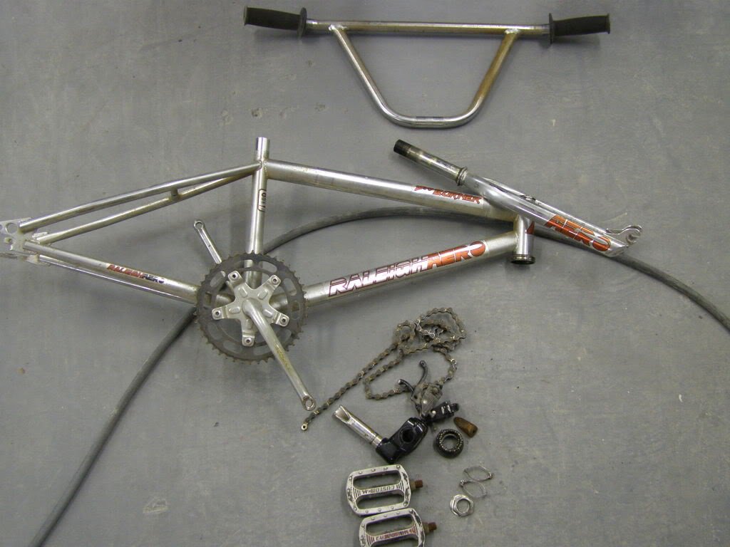

Hi all, im new here and i was sent here by some kind people over at burner world, i have had my aero pro in the loft gathering dust for the past 15? years.  Im looking at doing a custom paint job on it and just getting it fixed and then maybe modding it a bit so all help and advice will be greatly appreciated.
Im going to be painting my bike like no other bike has ever been painted before of that im pretty sure? but first i need to sort out the frame damagae.  PLEASE help and also please feel free to explain everything, im not familiar with a lot of the BMX nomenclature.  and something that will be pretty obvious by now i would think is that i cant spell either.

1st things first mate, strip the bike completely down to the frame and forks so we can see it clearly, then explain what exactly needs doing on the dropout. Anything can be easily fixed with the right person.... strip it, clean it and wack up some more pics!

fuzzynod is the man to speak to, he has just done exactly the same job on the same type of frame

Yup that's going to need the dropouts cutting out and new ones putting on  :daumenhoch:

This damage was not done whilst riding.  i wont go it to it, it's long a boring.  anyway ive taken the bike to bit as best as i can HELP, my mate is going to soda blast it, way less damage to the frame than the normal sand or aqiv.  great for car bodies and other things that yoyu dont want dipped, anyway that not important.
Here are a few more pics.  the front forks are in great condition.
how the hell do i get this undone??  HELP please I is Thic.
dropout pics
and the other pieces.

the bb is left hand thread, get a hoofing great flat ended screw driver and twat it with a even bigger hammer that should sort it
Re: HELP damaged aero pro burner dropout has done just that!
« Reply #11 on: July 01, 2008, 08:04 PM »
bloody hell! thats some chewed up dropouts!

To get the crank off, you need to unscrew that ring thats at the BB. There are 2 slots each side, but no hex or anything to get a spanner on. Get a "hoofing great flat ended screw driver " and tap it round (or "twat it"). You will need to hold the crank to stop it spinning. Maybe put the crank in a vice to really give you something solid to work on. Make sure you turn it the right (or is that wrong) way.

its not a major problem making some new dropouts

finally it is stripped, again thanks for your help guy and girls.  also fuzzynod has been in contact so, i just need my mate to strip the back end ready for him so that if he can do it, its ready to post.
