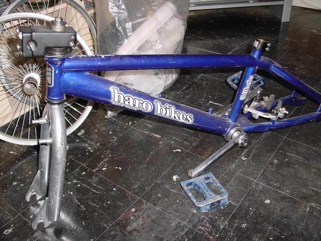

Bit of an update on this....
Who loves nitromors?
Not this bike!
It looked like a metallic hammerite type of paint before gettimg the grey coat underneath
Now primered-needs a sand down and then back to grey for this one!
Let me know what you think so far-(should i ask?!)
Be fair-this new school stuff is deffo new to me!

Thanks to all for the advice,and at long last,its done!
Cheers to Brianp for the decals and saddle(i know,i didnt use it!having it repaired!)
Cheers to Davemc for the cranks,chainwheel and brake-it sprayed up ok,didnt it?
The original idea was to paint it in grey-as it was-but i wanted something a bit brighter,and a colour i hadnt already got,SO.................
The paint is Ford Electric Orange(or St220 colour!),sprayed with aerosol-2 coats of primer,sanded,2 coats orange,sanded,2 more orange then 2 coats of lacquer!
Wheels are new-Alex Y22 48 hole rims,tyres by Wilkos!
Chain from Asda
New gyro
Brake lever from stuff in the shed!
Enjoy!

Are those forks bent backwards?
JT71
Re: Haro f+f unknown......*NEW PICS-ALL COMPLETE!*
Reply #44 on:
July 28, 2008, 10:32 AM »
Quote from: TwoBobRob on July 28, 2008, 10:08 AM
I was wondering that myself...couldn't figure if they are or if it's an optical illusion.
certainly don't look like a straight line forks to stem.
but other than that, and that the stem needs dropping down, it looks superb. good work.

Well done - another bike brought back to life!
One thing I dont understand though...
Mirra frames were all 1.1/8" for aheadsets and threadless forks... with a clamp on stem
How come there is a shafted quill stem in there? Is it a 1" frame? or a 1.1/8" quill stem? Or 1" forks in a 1.1/8" frame?
macky
Reply #46 on:
July 28, 2008, 05:01 PM »
Ohh yeahhh!!!
The actually are 1. 1/8 aheadsets....
are they threaded forks you've put on it??
shorty50y
Reply #47 on:
July 29, 2008, 07:19 AM »
Yeah,I think the forks are bent slightly-but this is how i picked it up!
The forks are indeed threaded,with a quill,but again,its how it came to me!(bearing in mind,it spent some of its time in a river.....!)
I havent any other forks to put on-I thought it may have been changed at one point,cos there is no way of mounting a front brake other than a caliper type!
TBH,its not that important-its more of a learning curve-I hadnt sprayed stuff before this bike!(Argos cycles in Bristol did my last resto paint job!)
So,I'll ride it slow(age...........its a curse!)And all seems well-no wobbles or niggles with it?Frame is 1.1/8th,hollow stem,but stem doesnt fit my burner-which is 1 ".....go figure!
Just glad the colour came out right!
