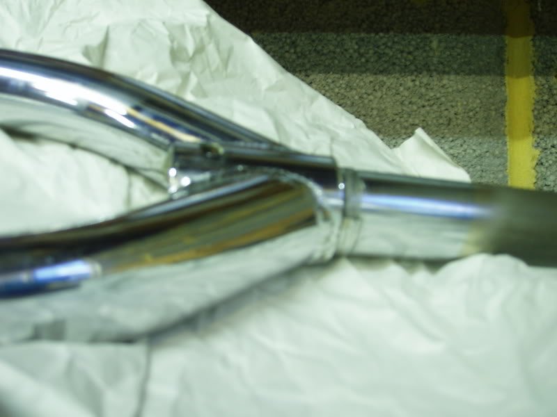

I have a set of forks that has a small piece missing from the fork crown (where the crown race fits). I haven't tried a crown race yet, but can you repair them? If so how or is it not worth it?

Is it like a chunk missing or all around ? Will it mean the race is wobbling about Phil?  ???

if the surface the crown race mounts to has a dent in it, I would just ride as normal as long as the crown race still fits. Wouldnt worry about it.
If its bad, I suppose you could eithet stick is straight in a lathe and machine the level to match the groove or braze in a filling and file it down, possibly also with some lathe at the end to make it tidy.

have you got a pic ???,but by the sounds of it you could build up area with a bit of weld and grind-file to shape ;)

Right - off to get a picture  :daumenhoch:

I would be reluctant to apply too much heat, if its going on a rider. They are heat treated usually, after the assemly and "tigging" has taken place, I believe. Get it too hot and you will screw up this process.

Don't know if you can make it out or not ...............................

as far as i can make out by the pics there is a bit of the shoulder missing ??? if so just a bit of weld should build up area,and shape with sander-file ;)

I suggest you get someone who works with lathes to spin the whole thing off. Then make a shim for applying the crown race,
I have to use a shim to convert between JIS and ISO, made a copper shim, works a treat.

Electrical tape can work wonders in situations like this  ;)

or strips of tin foil :daumenhoch:

I always used that special headset race shim material ... the stuff that come free around coke when you get it in a can

yep same as alex as had a few forks bitd that needed that ,never had a problem after
