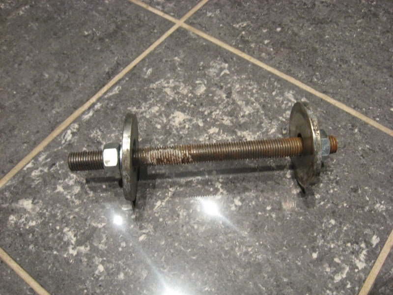

Goose1
Re: fitting headset and BB
« Reply #6 on: December 06, 2008, 08:15 PM »
I knocked this up at work.Bit industrial I know but it's perfect for both jobs :daumenhoch:

karlos100
« Reply #8 on: December 06, 2008, 08:25 PM »
thought about makin something similar but being a frikkin perfectionist i didnt want to leave any marks on the headset as its black to match the frame. shame when i unravelled the frame it was scratched anyway and needs touchin up in a couple of places. tut! next week im pressing a chrome tange one into my other frame. i think that will go bit better...hopefully!
