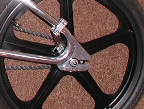

We ran coasters BITD, mine was on a quad, and Faze7-Dave's was on his Ripper.
We used the MX seat clamp trick, and didn't bother bending the coaster arm - we just let the arm flex into shape when we tightened the clamp. We ran them like this without any problems.
Photos - to help.
You should be fine.......

Hi. I think I took the arm off the wheel to twist it.  Put one end in a vice holding the bit that goes near the hub flat and put a big adjustable spanner on the other end. It didn't take much to do.
Looking at the picture reminded me to say I put it on the bit of the rear triangle that goes up to the brake. It's not on there now though so I haven't got a picture.
When I had some spare time at work I made a special clamp up with the right size hole in it, which is on the bike now.
Not a brilliant picture, and I forgot to say it's an original Suntour coaster.
