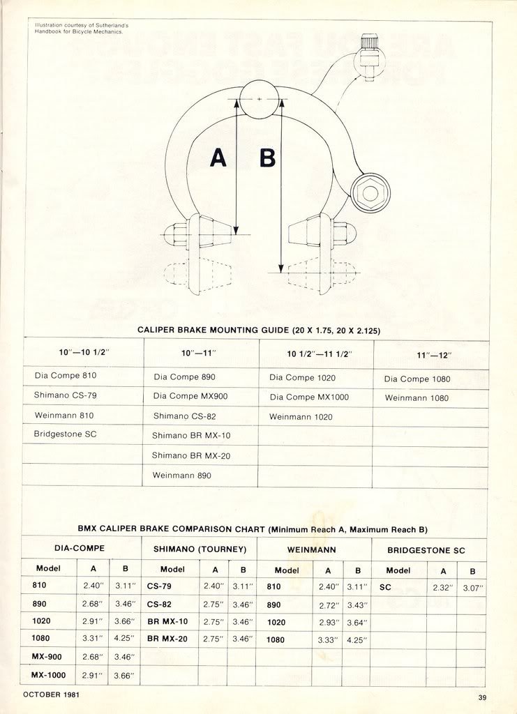

This is from an October 81 magazine, thought it might be of interest. My earliest caliper is 1981. A lot of built up bikes from that time came with 1020's though.

Not seen that article before, very nice ;)
A 901was first advertised late '84 btw. The earliest ad's I can find for 1000's was '80.
