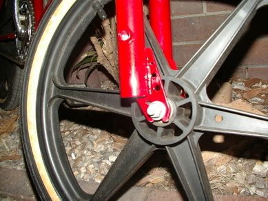

Heres a few from my collection.....
Tuff 1
Tuff wheel II metal hub...
Tuff wheel II alloy hub....
Tuff wheel II plastic hub....
Skyway OE's all had plastic hubs.
And the little fellas 16"..........

Tuff 1's also came in stamped and none stamped. I think the older (first) models came unstamped. Not 100% sure though.
