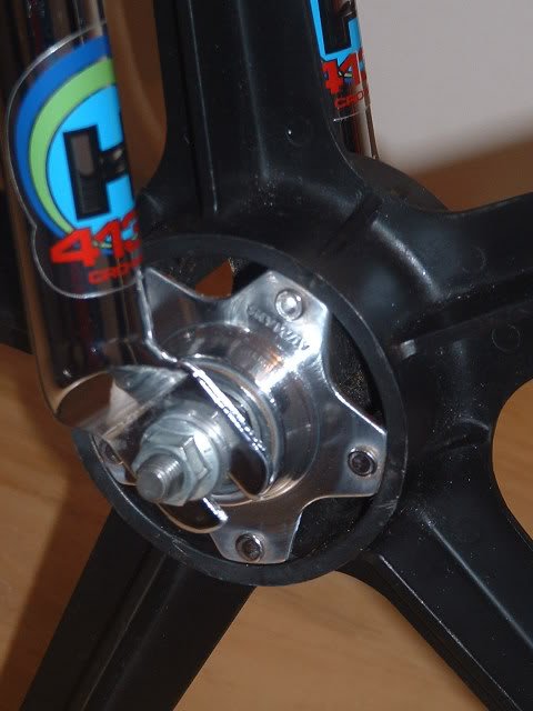

Here's a stem I did some time ago . . .
BEFORE
AFTER
Cheers
Steve  :daumenhoch:

that is a nice stem looks better silver than in white how long did it take to get that finish  :daumenhoch:
Not long really . . . that stem had been painted with spray paint which came off real easy with Nitromors
I do all my polishing by hand too and in most cases I don't use a mop . . . just good old Autosol on a soft cloth
Here's a Pro Neck I've not long finished too . . .
BEFORE
AFTER
Cheers
Steve  :daumenhoch:
