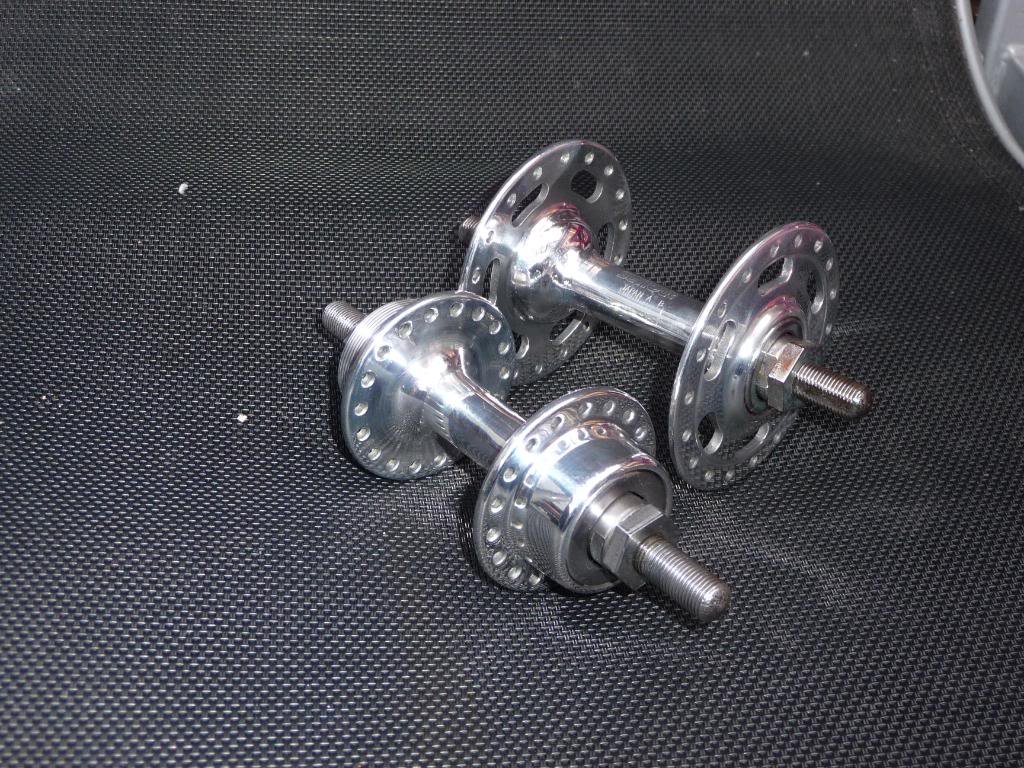

the best thing  i found found polishing  is
http://www.radbmx.co.uk/forum/index.php'topic=86658.0
all joke aside  get some   "  peek "   off ebay its the dogs back wheels
