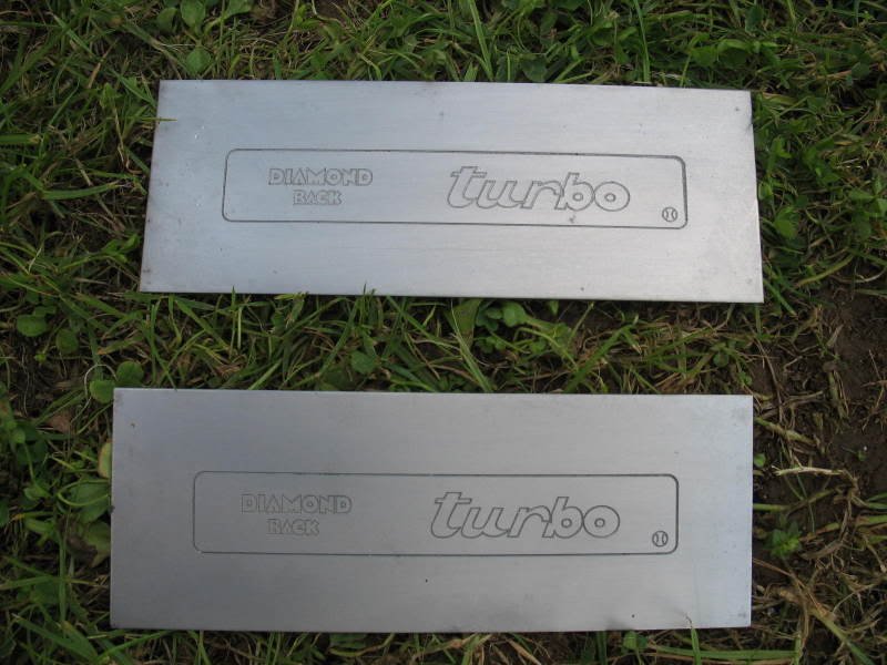

Offline sawzall
  • Posts: 2793
Re: re-stamping 401's!
« Reply #5 on: June 04, 2009, 07:50 PM »
if i were you i would try a commercial engraver i had these repair plates made for a set of db cranks and were spot on

 :shocked: Now that does look like the answer to all your problems 8)
« Reply #11 on: June 12, 2009, 07:11 PM »
how much did he charge ya to ingrave em as i have some turbo plates with the writing ready for stamping
