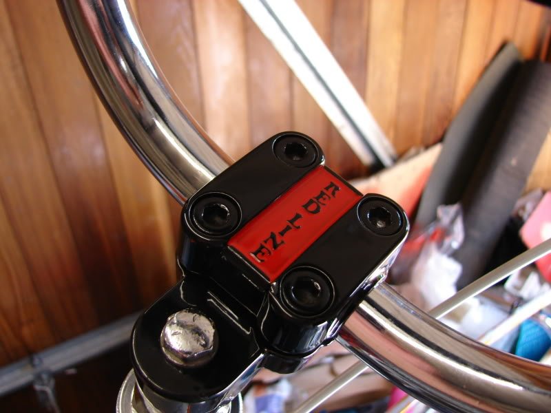

i got a brute stem off mr radman ,,that had been restored previously
but not to much standard ,looked like it had been touched up here and there with a black marker
so i thought fook it get the paint stripper and costic out  :crazy2:
i sent it to dan to be powdered ,(top job) then the only thought was the writing ,theres no way i could paint that with
my dt's ,,,,,,,,,,,,,,,
then i thought ,ill mask up ,and spray the red ,,then in the morning ill t-cut the lettering ,,,not a bad result me thinks
so there you have it guys the way to sort your lettering out on the brute stem ,,,,sorry if this has been mentioned before  :tickedoff:

What red did you use?
trasher
Re: brute stem tarting up ,,,,,,lettering sorted
« Reply #8 on: July 05, 2009, 07:40 PM »
bright red ,gloss super ,,plasticote ,,from b&q mate
yo glen, that's a first class job mate, really impressed :daumenhoch:
cheers dan ,,,didn't want to mess up your powdering dude :daumenhoch:

Thanks bud,I'll go look for some.nice job on the stem!
