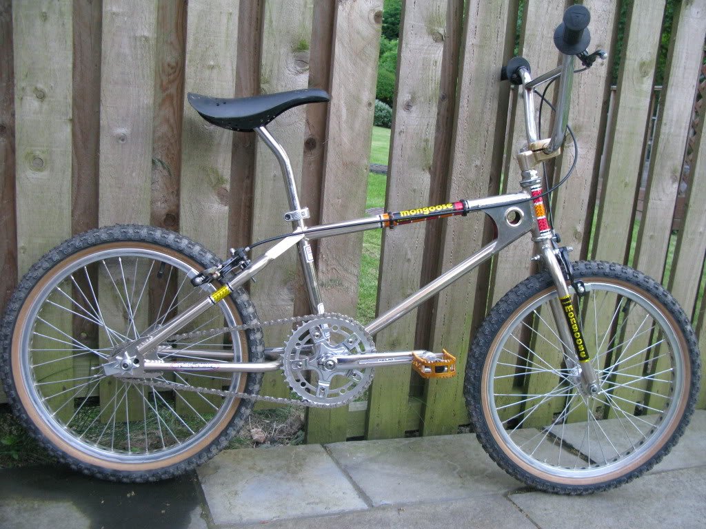

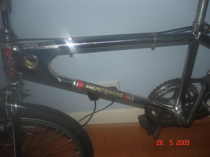

Well it all started a while back when Lis (member: "lmmrst" ) put a thread up for all to see saying "anyone interested in buying a supergoose" and with me not being in to mongoose much I totally ignored the thread  :D  :-X :LolLolLolLol: Anyways cut a long story short Lis gave me the guy's details (once again thanks for the tip off Lis  ;) ) we haggled out a price (a fookin good one to  ;) ) and I got myself (another  :-[ ) supergoose - so here is the original piccies the guy sent me :
So first thing first I decided I was going to salvage a few of the original goose bits for some of my other builds and keep just the frame, forks, mongoose stamped headset and proclass wheels everything else was going to be custom for a change.

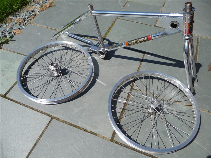

First job then was strip down and clean up - ideally the wheels could do with re-lacing with new spokes but they spun true so I thought fook it  - it's a rider  ;) Stripped them down - changed the rim tape, changed the bearings, cleaned the axles and re-greased everything.
Here's the frame / forks & wheels after clean up and light resto :

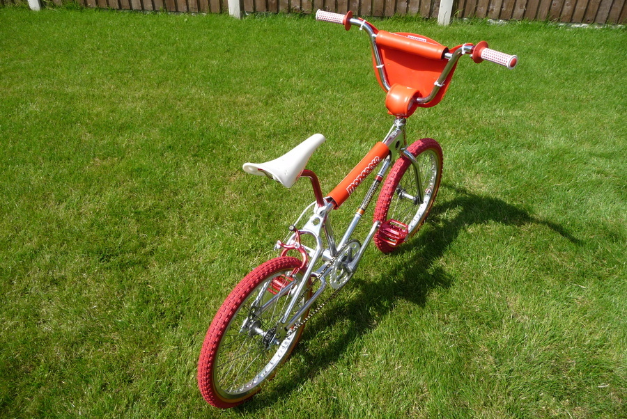

PARTS:
1982 supergoose frame & team forks (serial J2003415)
1983 un-stamoed GT pro bars (with custom decals)
alloy pro-class rims with shimano hubs (and custom pro class decal)
NOS Rad Kaps Dice
NOS renthal layback
NOS viscount aero (custom mongoose decals)
NOS Dia Compe MX hinged seat clamp
SR Apex-M 3-piece crank (donated by "currio" cheers mate  8) was blue with a few scrapes so it got the oven pride treatment  ;) )
Sugino 44T powdered white (by SBD I think - it's done the rounds with a few Rad members before it ended up with me  :) )
NOS Shimano SX
NOS FUAN F1 grips
NOS Dia Compe 901's (changed cables to white)
tuff pad copies
Forklifter style stem (possibly mongoose as it has similar markings to pro-class bars of the same era 85-86 ish and the freestyle geese of that era came with them - I rattle canned this and added a custom mongoose decal)
comp 3 pattern tyres thick/thin combo (7 stars brand  :-\ )
NOS haro race plate (with custom decals)
re-pop mongoose vinyl pads

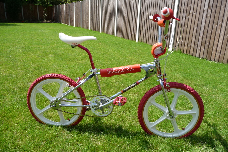

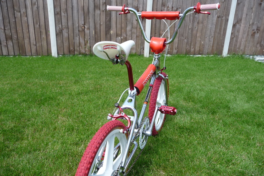

So here she is ready to race in the novice event at MK :
But the story doesn't quite finish there...................... :LolLolLolLol:

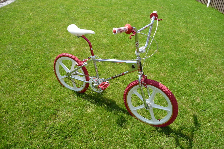

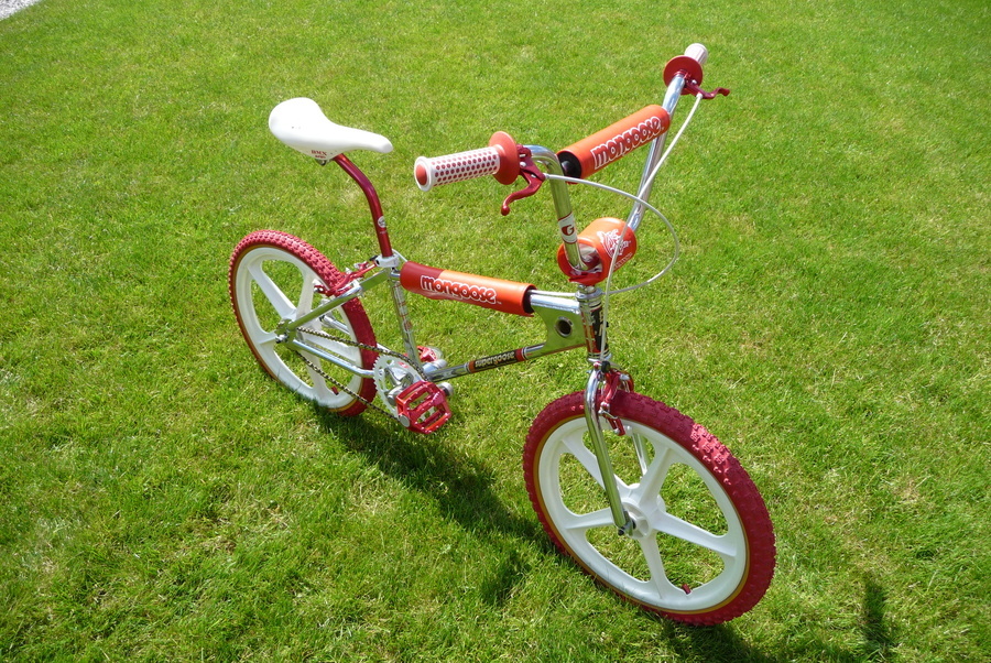

............looking at her I just had to try out some white tuffs and stick the front brake on - so here she is in "street" mode  :coolsmiley:
Finally here are some detail shots of Del's masterpieces  :4_17_5:
I stuck a poll up at the top just for a laugh - so which do you prefer "race" stylee or "street" stylee ?  :D
Hope you like her lads.......... see you all at MK   :Great_Britain: 8) :daumenhoch:

Race styley! :smitten: :smitten: i've fell in love with this, keep going back to look! get in BOTM quickly! :4_17_5: :4_17_5: :4_17_5: :4_17_5:
munners
Re: 1982 supergoose FINISHED (in 2 styles....... race & street)
« Reply #2 on: July 16, 2009, 08:40 AM »
Like! ;)
Proclass rims for me though.
Top geezer for keeping original decals on it! :4_17_5:
I fancy an old mongoose with proclass rims.  >:D
« Reply #3 on: July 16, 2009, 08:46 AM »
nice  :coolsmiley:
prefer the race trim out of the two  :daumenhoch:
« Reply #4 on: July 16, 2009, 09:57 AM »
Looks brilliant John , well done mate   :4_17_5:
Personally prefer it with the spokes ...... it looks faster ...... and your going to need as much speed as you can get for the Novice racing at MK  :LolLolLolLol:
Top build though mate and Del has worked his magic again  :daumenhoch:
Looking forward to seeing it Sunday  :D
