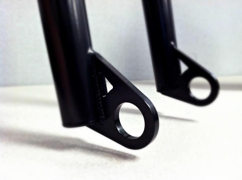

I dont know much about racing BMX's but I do know the big boys go real fast. The stresses involved are gnarly and even "light bikes" need to be able to hold up to the job. I just lifted these pics and story from the S&M site.
Yesterday we posted a photo of some prototype forks with new style drop-outs, on our S&M Facebooger. Some of you got your panties in a bunch real quick, but here's some info to pick that wedgie from yo ass. These are 20mm "Through Axle" dropouts made for the newer race hubs. The current forks suitable for these hubs are basically shit. So we opted that we get some American quality in that game. Keep checking back for updates on these bad boys.
We wanted to make a burlier race fork for the new 20mm race hubs, after seeing this vid.

I'd say that its not really to do with using spacers (although I do think you should always run the stem right down and use a stem & bars to give you the height you want). Its more from having the thread inside the fork going below the stem. If people didnt use spacers on those forks, then they removed the problem because the stem would be lower than the threads.
Its pretty crazy to have a thin, light steer tube and then cut a thread into the inside of it. Esp as the "solution" is then to screw a big lump of ally in there. Why not make the tube thicker in the first place, and/or have a separate insert with the threads on it? (glued or welded in)
All S&M forks have a threaded insert welded into the top of the forks. I dont like it cos it makes it harder to get a cable down there, but Im in a minority, for sure
