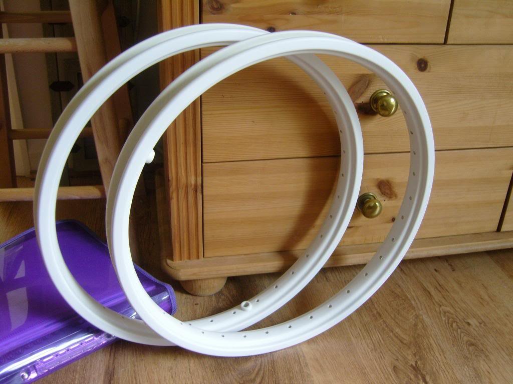

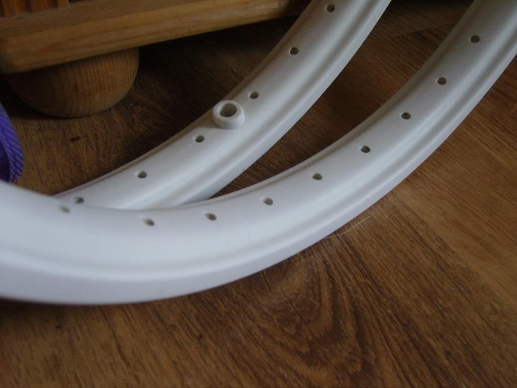

I have done some Z's for agayguff - they had brake rub that had worn in and gone hard - cuts and digs into the rim
i scraped the brake rims away to clean and then went through a three stage wet and dry paper sandaway - i then had to get the original shape back and make them smmoth and look like were back in the day - then stuck them in bleach for a week to get them back to white  (just waiting for swivel to send me some decals to finish it off)
you can see that if you put in the hard work, you can sand back to mak them look clean again and back to the right colour - it just takes time - the smoother you get them they will look a better colour as the is more solid

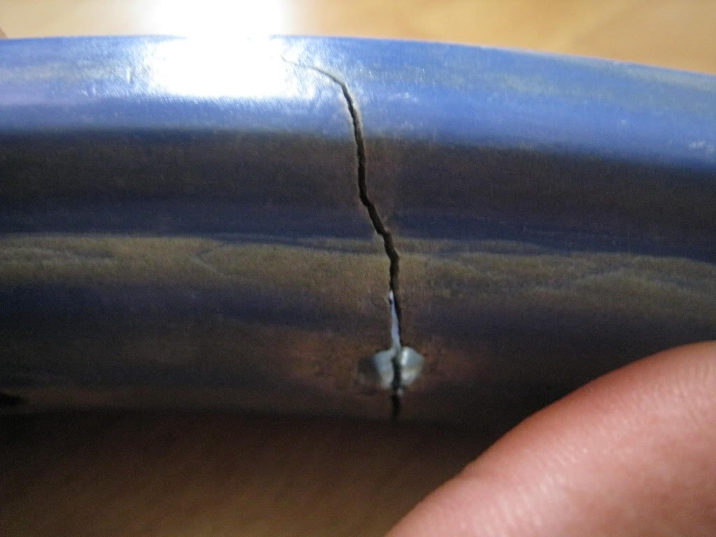

But and a BIG but I have found a split in one of the rims and am mega pissed off now  :'(
they are hanging on by 5mm each side of the outer rim and 7 mm inside rim
can i fix this to ride them or is it goodbye sweetheart ?
as you can see with a little pressure i can open the rim up
Re: ACS Z Rim Resto help needed
« Reply #24 on: September 11, 2011, 03:41 PM »
That rim is scrap mate.
