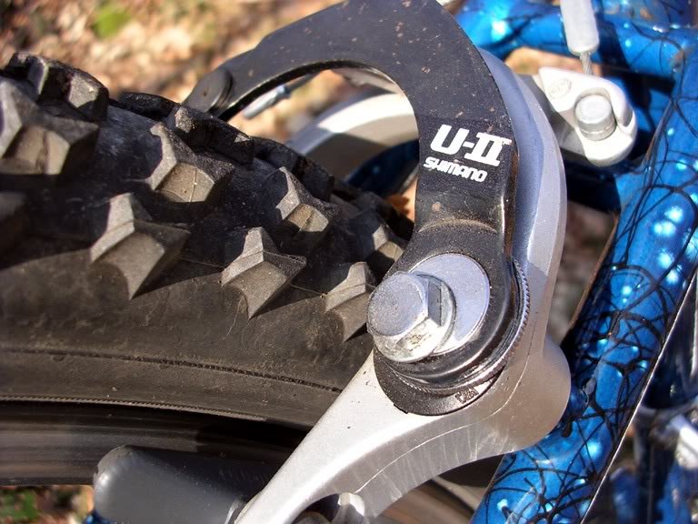

in the 90s, Shimano U brakes came with a "booster" plate.
They are dead easy to make for any brake. Much simpler than Vbrake plates  :daumenhoch:
We used to make them out of chainrings so you had TEETH along the top of it!!!!  8)
« Last Edit: October 17, 2011, 02:32 PM by S&MAlex »

corker  :daumenhoch:    likeing the chainring idea  :4_17_5:  is that a 10p spacer ?  :LolLolLolLol:  quality  :daumenhoch:   ( the cam bit... )
« Last Edit: October 17, 2011, 06:24 PM by oldtired »
Re: opps i did it again!! (cracked dirtbike no2)
« Reply #22 on: October 17, 2011, 11:01 PM »
Its not a 10p, its the edge of the cam bit which is serrated to make it easier to rotate.  :daumenhoch:
(but its not my bike, i just googled those brakes. Come on, I dont have a Mountain bike!!!!!)  :knuppel2:
