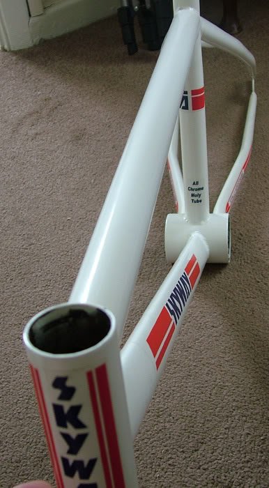

I would like some opinions on this frame please. I know Dirt Bros bought up Skyway frame and fork sets in the early 90s and rebadged them... The frame number is T4A2327.
Offline billstup
Re: Dirt Bros Skyway Ta
« Reply #1 on: October 22, 2006, 02:33 PM »
Well it differs slightly from a normal T/A, the rear dropouts are missing the cutout, and the brake bridge is straight instead of curved, which is the sign of an early T/A . The serial number on a Skyway T/A doesn`t have any letters in it either, apart from that it looks fine  :daumenhoch:
« Reply #2 on: October 22, 2006, 02:43 PM »
I think those little holes in the chainstays are closer to the dropouts as well
But that looks a fine frame  :daumenhoch:

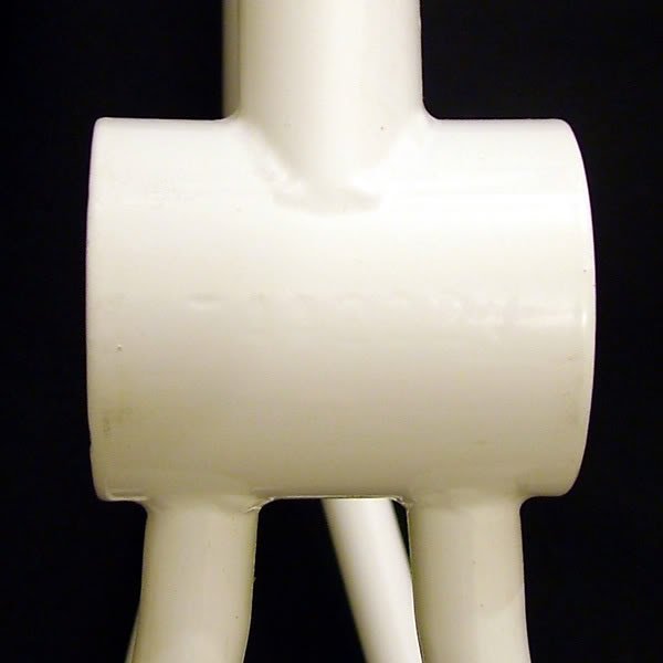

That serial number is completly different from a Skyway one, a Skyway one goes from front to back of the bb instead of across like that one Andy, I`ve tryed to take some pics of mine to show you, but the powder coating is too thick and it wont show up. but I`ve took some pics of the rear drop out that shows the difference between mine and yours :
You can see where the holes and cutout on the dropouts differ from yours.
