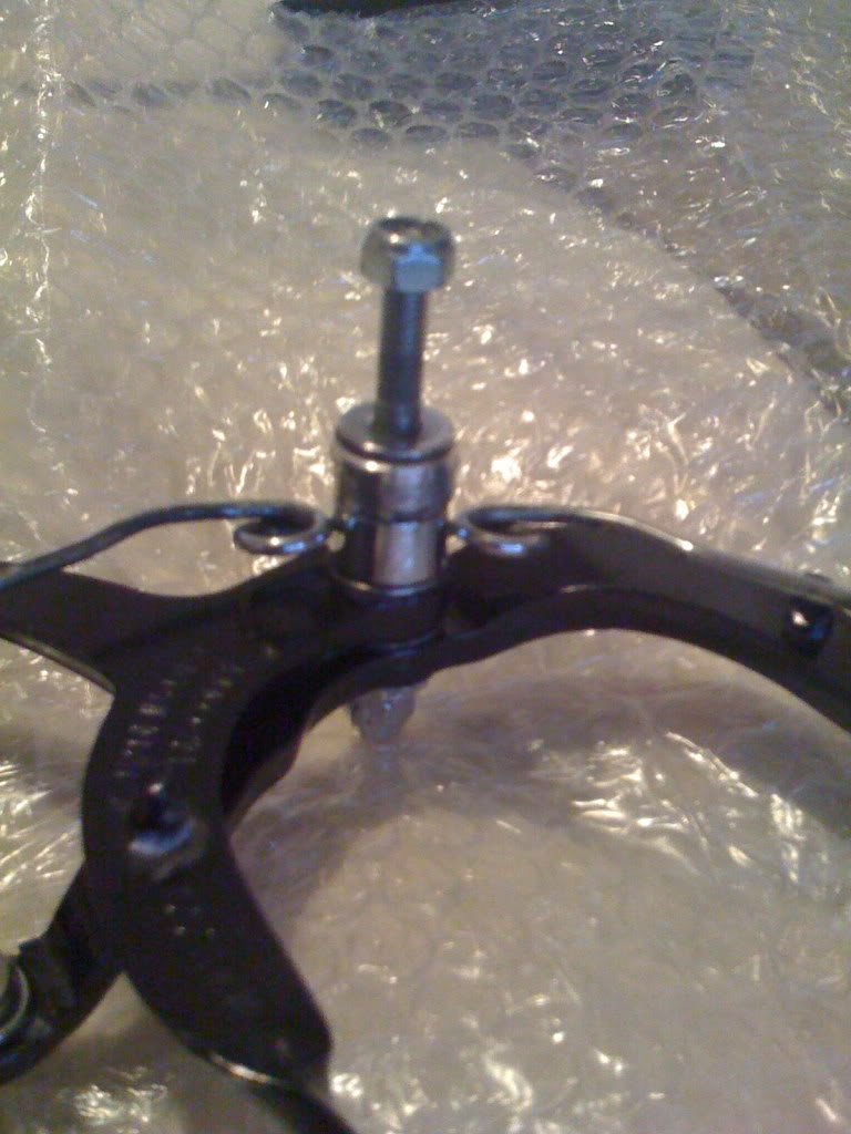

OK, just a little parts update. Just got home and found my rear brake cable has been delivered. Can't believe how difficult it was to track one of these down - maybe I was looking in the wrong place!!
OK, I do have a problem I posted in a previous thread but I've tried to fix it without success. I bought an MX1000 brake in black, but the bolt is wayyy to long for the fitting on the rear of my frame, which is flat on the Laserlite. I thought it was a front brake so bought another spindle from a Rad member but it's identical to the one already fitted to the brake. I've offered it up the fork, and the spindle is too short to poke through, so it's definately a rear brake.
Does anyone have any pictures of the rear brake fittings on their Laserlite, or another bike with a flat brake fitting? Any ideas on how I can fix it - you can't cut the spindle down too much as only a part of it is threaded.

Can you add some extra washers Rich to space it off mate so the nut then goes tight on to the thread ??????
rhino_mac
Re: First Ever Build - Kuwahara Laserlite KZ-83
« Reply #17 on: April 06, 2009, 07:04 PM »
You could.............I was thinking of turning the fat washers with the curved cut outs (for a curved brake bridge) round so the flat parts touched the flat bridge, and then adding washers behind that.
But you would need 10mm+ of washers and it's going to look complete crap behind the bridge. I wondered if there was another option - did Dia Compe do a shorter spindle available for flat brake bridges?

i used a 6mm die with a 1mm thread pitch to put more threads on then cut it shorter.

Dc did do a shorter rear brake calliper spindle. Many were used on the mk2 top end of the burner range. Models like the ultra and the supertuff. You may have some luck trying a guy on burnerworld called buttsbikeshop alternatively put up an add in the burnerworld wanted section. :daumenhoch:

as Boofy said,run an M6 die down the spindle,done it MANY times,works a treat.
