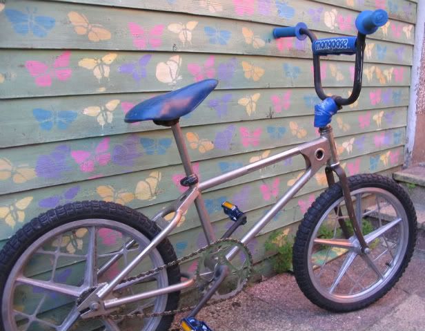

fatgoose frame
no brake bridge,
small frame gusset,
disc tab,
flattened rear chain stay,
no holes in rear drop outs,
solid box section,
nickel plate,
Serial CC1 399197
