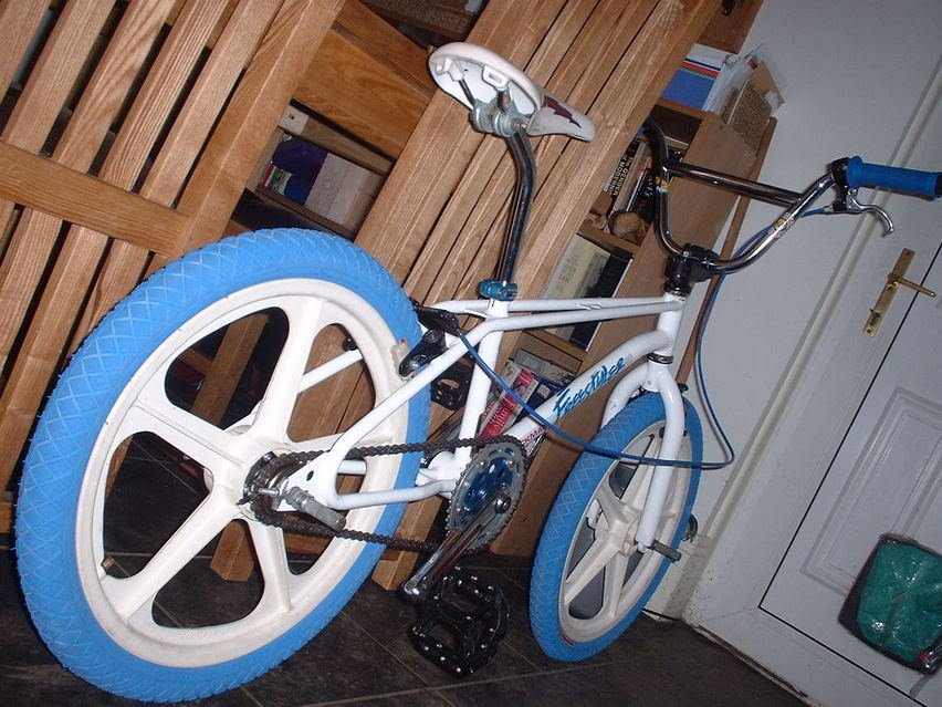

Been a while since iv'e done one of these. I used to have 5-spoke skyway tuffs on this but the brakeing surface on those is beyond shit. I also had some other old parts on it. I had a 91 haro master frame with alot of the new stuff on it since the master had more modern geometry but I was more comfy and all on the F.S.T.(this frame) so I threw all the new stuff on it. I put some forks with a threadless steerer tube on it so I can run a gyro and a better stem. I also ordered a 23t sprocket and an ody 1-pc 10t driver for it. Remember in flat you ussually want a slightly offset gear ratio. I was gonna do 28-12 but my lockring got ****ed and albes had the 23t sprockets on sale so...  Before you talk shit remember that I use this bike for flat and that some of the stuff is 20+ years old so if you wanna say somethin shitty, don't bother typing a response.
Weight:30lbs
Year of construction:1986
Cockpit:
Frame:1986 haro fst, repowdercoated and restickered
Forks:Redline tapered tubing forks
Bars:Haro kneesavers circa 1991
Stem:S&M redneck lt.
Headset:tioga beartrap 2/+ parts from a 1 1/8 threadless
Grips:ame tri grips
Bar Ends:ame
Brakeing:
fr. Brake:Dia-Tech Hombre Fiesta, Red
rr. Brake:Dia-Tech Hombre Fiesta, Red
fr. Brake Lever:dia-compe tech 77
rr. Brake Lever:dia-compe tech 77
Brake Cable:ANIMAL ILLEGAL FR, soon to be sst oryg gyro Rear
Brake Pads:KOOL STOP EAGLE 2 CLAW FR/KOOL STOP Thin-Line RR
Seating:
Seat:Odyssey 99er
Seat Post:PRIMO ROD
Seat Post Clamp:dia-compe mx hinged
Cranks:redline flight 2
Sprocket:Primo pro 23t
Chain:kmc 410h
Pedals:odyssey twisted platform
Bottom Bracket:redline sealed cartridge
Front Wheel:Odyssey hazzard lt.
Hub:Odyssey Vandero
Tire:Tioga Comp Pool, 1.75
Back Wheel:Odyssey hazzard lt.
Hub:Odyssey hazzard cassette
Freewheel/Driver:Odyssey 1-pc 10t
Pegs/Stands:Front-88 25 pegs Rear-88 25 pegs
It was hot as hell in the garage, so I just brought in some tools and did it in the kitchen. LOL it rides great too, the 23-10 is so perfect for flatland, but sucks for goin places!
I also threw in an old ridin photo of me messin around in the kitchen with the old setup. LMK what you guys think!

nice build mate
funnily enough, i just picked up an FST last night that had been built as a rider with a mix of old and new parts. rides real nice too. they are a good sized bike!
yours looks great. i like your style!

i like it mate, it's one of the thing i've been thinking about, i love old school frames but equally love the new school parts,
i see you listed a mix of parts for the headset and you have fitted a 1 1/8 stem, are the forks 1 1/8 too!
could you take a close up pic and list the exact parts used to do it,
thank's
use 1 1/8" forks, 1" cups, 2 sets of 1" headset balls (put them in the cups loose, you get almost 2 sets in each cup - not packed to tight though, as you will get a tight spot)
then use the rest of the top parts of the aheadset
thanks ruler, i'll give that a go :daumenhoch:

looks good mate!  but watch out for those freyed cables!!   :shocked:
