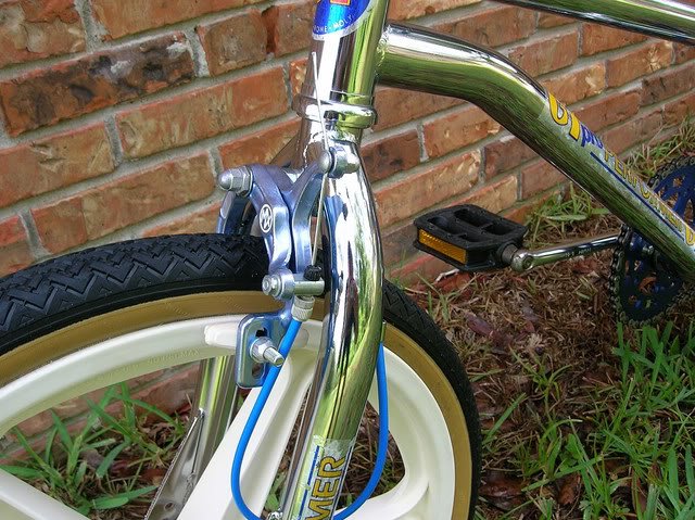

please forgive my unforgivable stupidity, but can someone please show me a photo of how a front brake will look when it has been fitted through a hollow stem, am i right in assuming the normal cable fixings need to be reversed ie the cable runs up into the brake instead of down???

What kind of brake are you using? If it's a MX or 880, then you are correct. All you should need is to have the barrel adjuster on the bottom and bolt on the top.

BMXA did a how to on Potts Mod, I'll dig it out and post it up  :daumenhoch:
Here you go....
BTW, you got to love that Hutch that's Buff's riding - prototype but a schweet one  :smitten:

i thought all Nippons were Pots mod anyways mate?

If you bought se's white dia-compe nippons ? the front is a pots mod  :daumenhoch:

If is the white Nipons, then they will be fine. The front one (on the left) is pots mod ready.
The adjuster at the top has a built in pinch bolt which is very nice.  :daumenhoch:

and the front is set up for the potts mod, trust me :daumenhoch:
