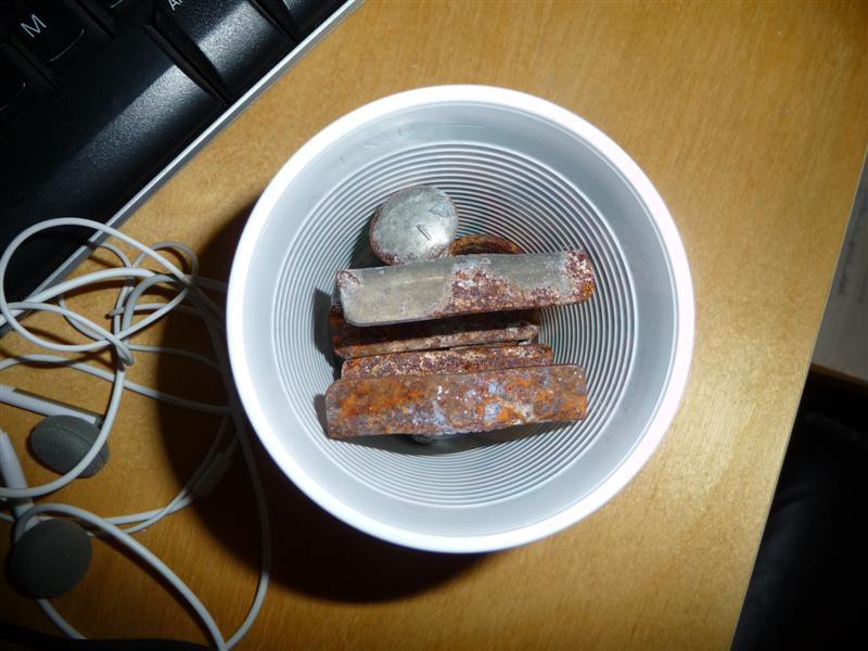

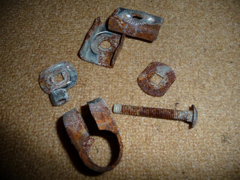

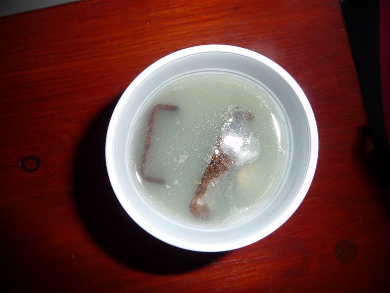

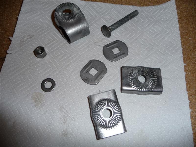

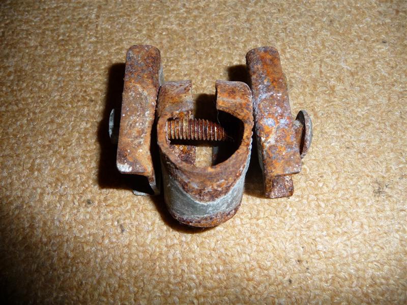

I use bottled lemon juice on rust  ;)

 :shocked: those are great results with the lemon juice.
Gonna use white vinegar first just because I've got some and take it from there.

looks like the bottled lemon juice does a top job! nice one mr fett i'll be trying that one  :)
