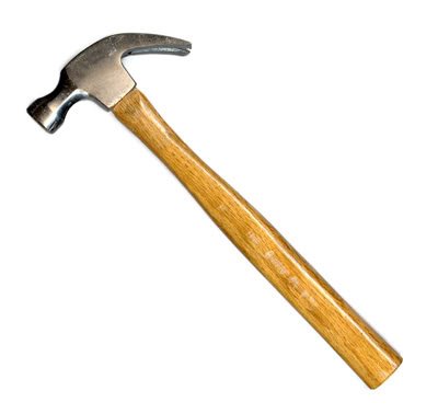

I do normally use the old wood and hammer method but I can't bring myself to do that on my freshly powdered frame.
