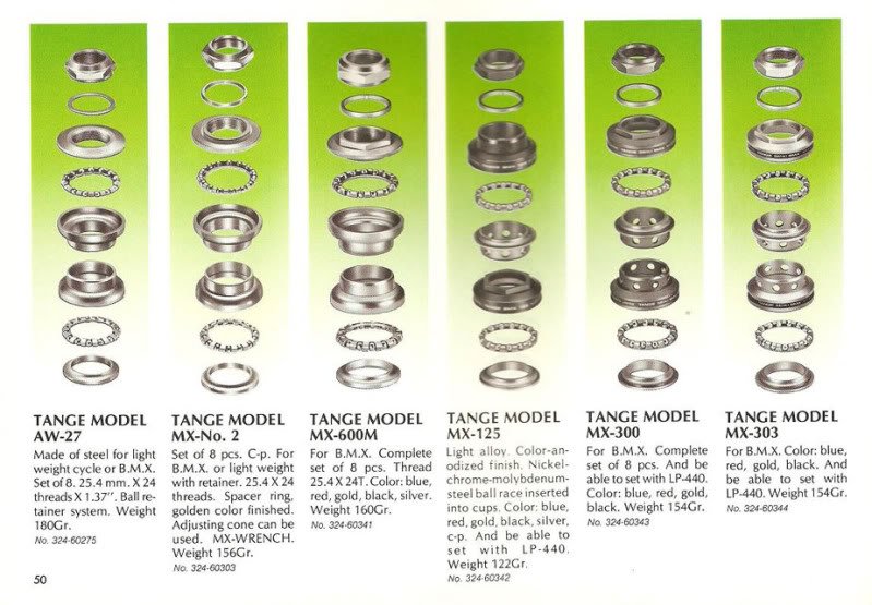

OK here's the story: Almost 2 years ago I (along with a few others on here) bought what was advertised as an NOS Tange 320 Headset. Since then this has been sitting in a box along with the rest of the bits and pieces I've been collecting. Noticing the prices increase over time, along with the fact that I'm skint, I decided to put mine up for sale (today). As always, I try to research the items I put up for sale but as I was doing this I stumbled across this potentially disappointing piece of information.
Tange 303 (left) Vs Tange 320 (right):
The last shot is a complete 303 set.
Checking this info against mine, it looks like I've bought maybe part of a 320 but also part of a relabeled 303. I have the O-Ring on the bottom piece (bearings also look OK) but no octagon or O-Ring on the Crown / Nut. I questioned the issue with the missing O-Ring at the time but was reassured by the seller that only the bottom race was sealed. Looking closer at the box it came in, it has a reflective 320 sticker on which, when I peeled it back, revealed '303'. Anyway knowing this I've now pulled the sale.
If you've got one, it might be worth checking what you've got.  :(

Here's a pic of mine. Can you tell anything from the decals?

The guy who sold to me said in his post he bought in bulk from the US :-\
The box relabel thing I could see as a factory thing but the Octagon (O-Ringed) Nut & Octagon Top Cup is the key.
We could do with a few more examples.

Re: Tange 303 Vs Tange 320 Headset
« Reply #7 on: February 23, 2010, 11:22 PM »
My NOS 320 has a single o ring only on the bottom and a hex 6 sided top cup and top nut.
and mine, was used.  :-\
monkian
« Reply #8 on: February 23, 2010, 11:25 PM »
What we've got is a 320 bottom and a 303 top labled as 320.
So the differences are:
303: no seals, 6 sided hex cup and top nut
320: single sealed lower part, 8 sided octagon cup and top nut.
Plus 320 has the O-Ringed Octagon Top Nut (I guess, effectively sealing the top part)
(this all looks like the case if the information is correct in those images)
« Reply #9 on: February 23, 2010, 11:30 PM »
yep hex 6 sided top cup and top nut
monkian
« Reply #10 on: February 23, 2010, 11:34 PM »
Yeah, seems odd. It'd be useful anyway to know for sure what's what.
I asked the guy who had the original images on ebay to send me this.
It shows the parts for a 'Tange MX-303' with unsealed crown (bottom) race.
« Last Edit: June 08, 2010, 05:02 PM by monkian »

The comparison Tange pics you have, are from a seller on ebay, who was trying to drive up the price of his 303's .
He was selling a 303 but took the time to point out the differences. That doesn't mean the info he provided is wrong.
I can't tell your 1985 Tange catalog pictures do not show a 320 headset
