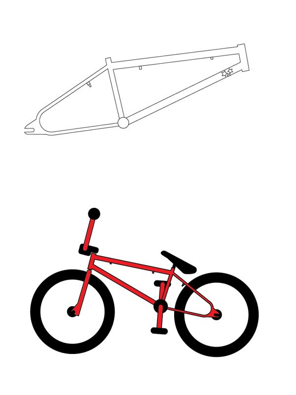

I sort of did a rough idea for a frame last year, nearly won a comp to have it built up for free if you won.  I came 2nd I think, haha.  But yer, loads to think about - alot more to it when you sit down a draw a few ideas out + from an engineering tec point of view I'm green as, haha.  But I think bikes tend to crack under the headtube on the main down tube mostly or where the seatstays meet, so I'm guessing they would be the bits to worry about.

Here was my rough idea from last year, think I might have posted it on here in another topic.

Thats not bad, if its a street/park bike then cool, if its a race bike mount the brake lugs on the top of the seat stays not underneath
21" TT
75 degree head angle
71-72 degree seat angle
Internal campy spec headset
Mid Bottom bracket
rear length and BB height will vary depending on what you want to ride (race or everything else)
More for trails and a bit of messing about on race tracks, doubt I'll ever race, but you never know.  Why would you put the lugs up top on a race bike?  I know most do, but whats the benefit?
