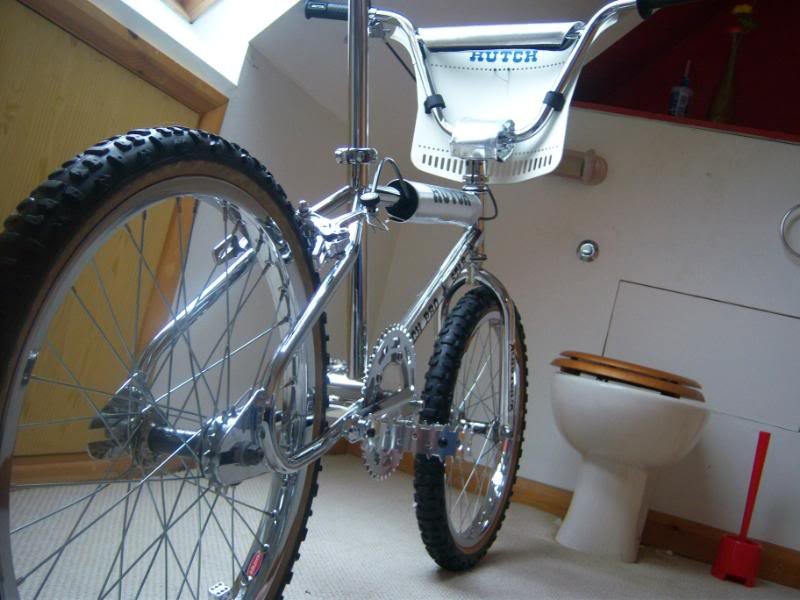

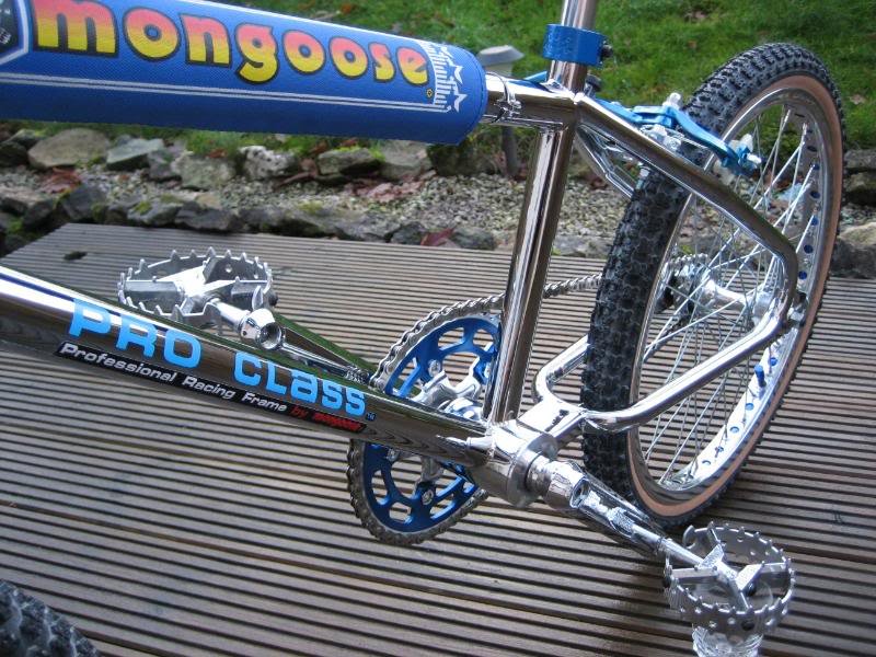

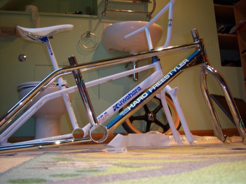

Mark put a rocket up their arse mate, the finish is totally down to prep, they have all the gear to prep well its just if they do or not. Dont forget your paying them money to do a job, simple as that, if you dont get a satisfactory answer outa them send it up here and ill get my guys to do it for you, they charge £170 for f&f and trust me they Prep. Here are 3 bikes they have done, you decide  :daumenhoch:
If you want their details Mark, PM me  :daumenhoch:
