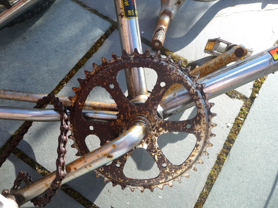

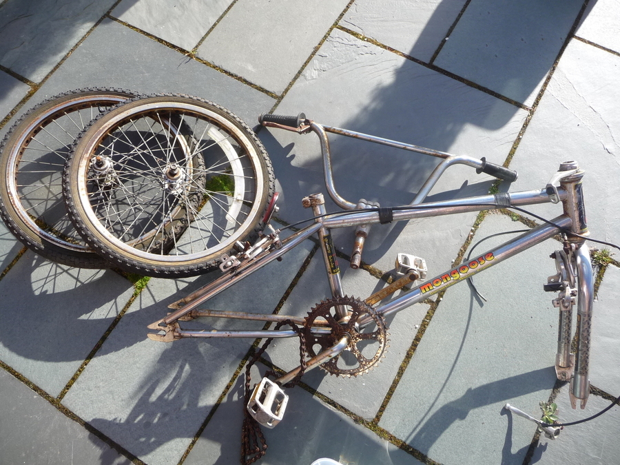

And here's the rusty little fooker after i got it back home...........
Needs some TLC  :LolLolLolLol:
I'm spending fook all on this ( well as close to as poss ! )
So it's lemon juice / vinegar / foil etc. and if the likes of the chainwheel can't be rescued cos they're too far gone then some chrome appliance paint may get used  :shocked: :2funny:

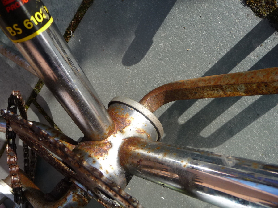

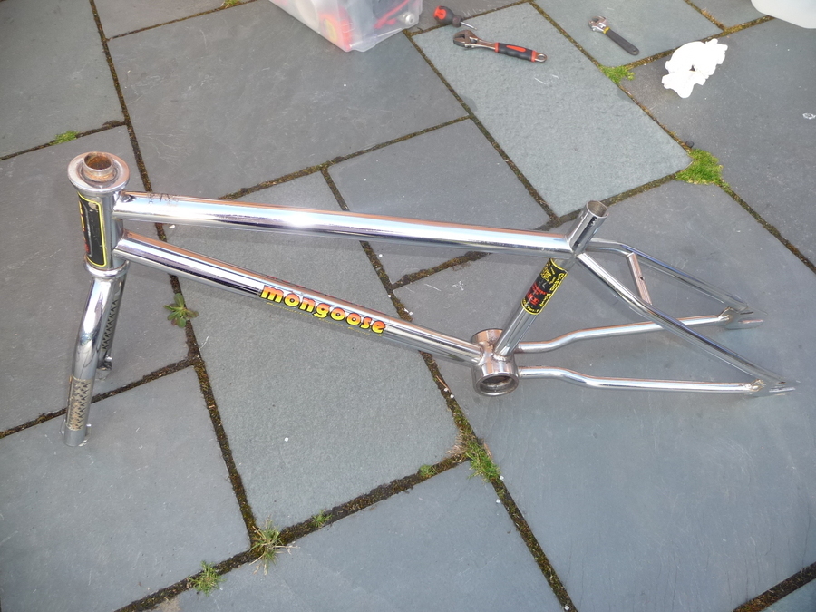

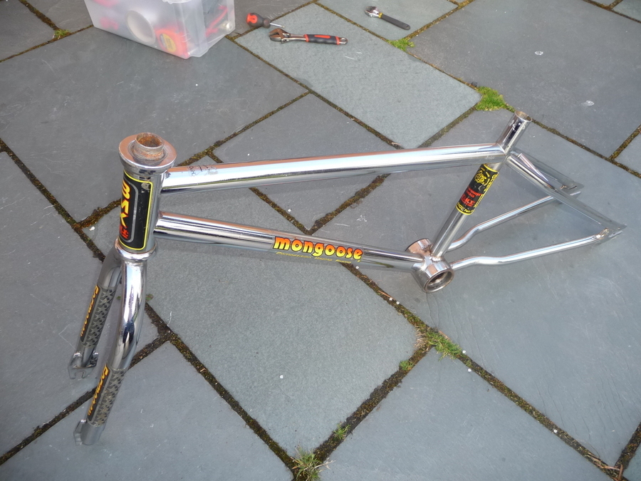

Right then stripped everything down and hit the frame with vinegar and tin foil  ;)
Quite pleased how it's cleaned up so it's staying chrome and the decals look alright too.........
Result !  :LolLolLolLol:

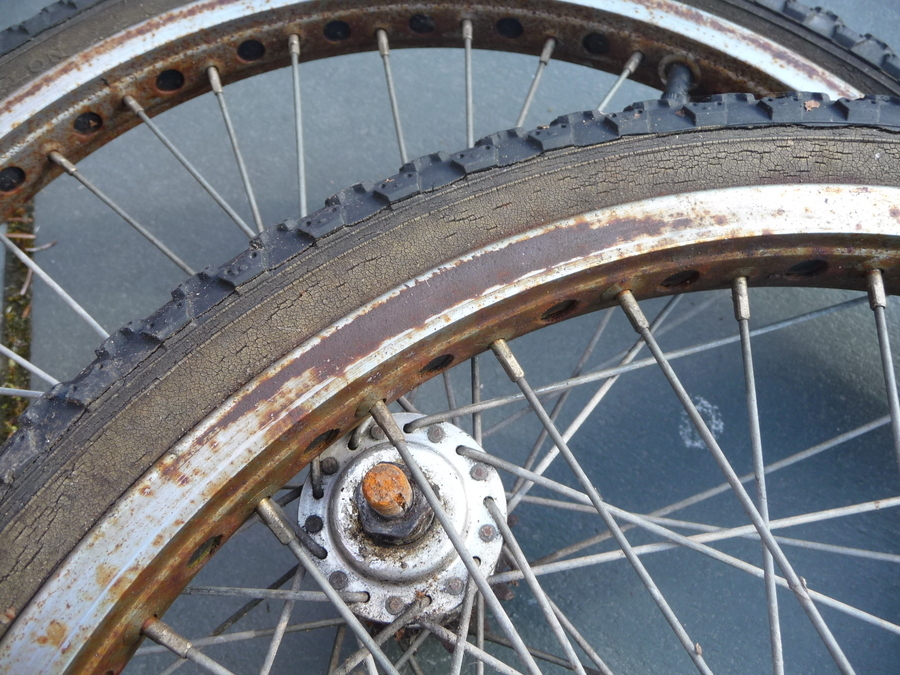

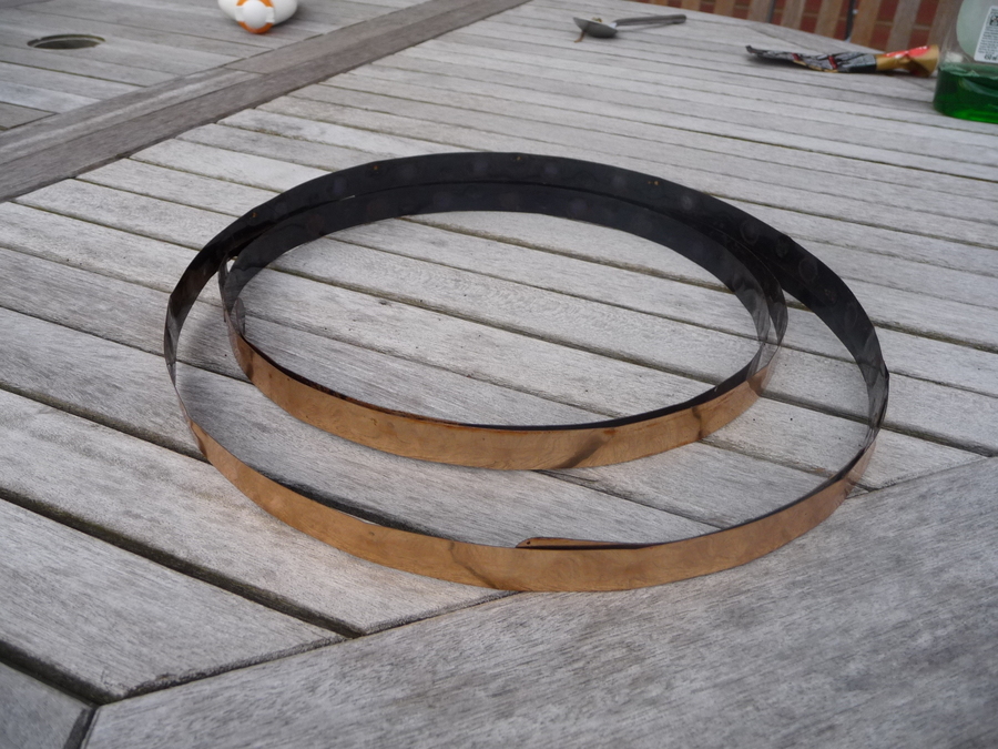

Peeled the rim strips out of the wheels and the were caked in rust  :buck2:
Thought they may have been bin fodder but..........
Hot soapy water scrub and they look OK........

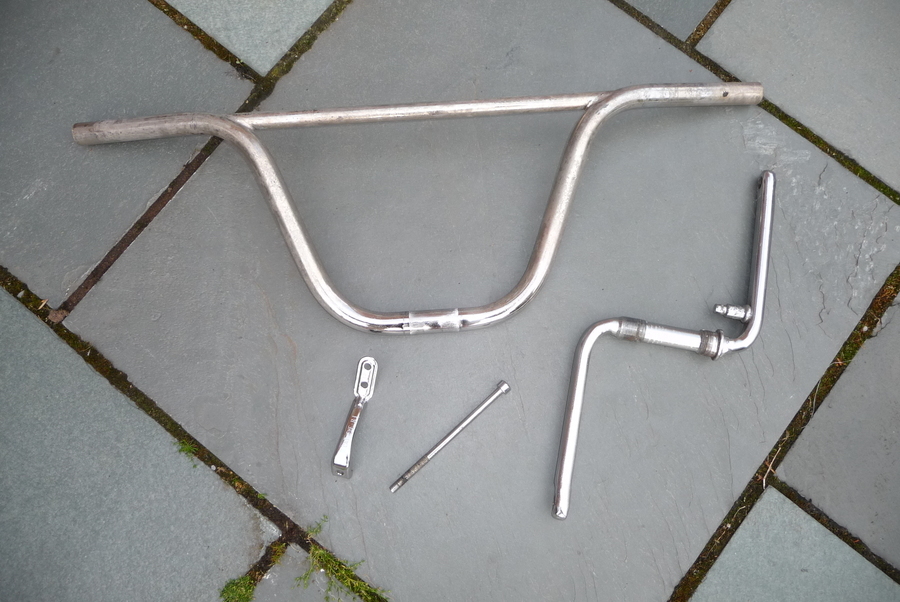

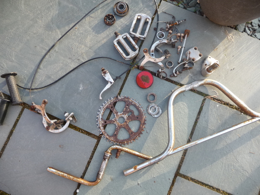

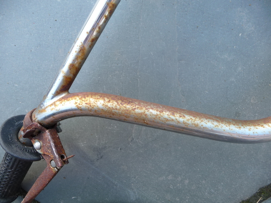

As for the rest of the bits well.........
They're pretty fookin rusty  :shocked:  :LolLolLolLol:

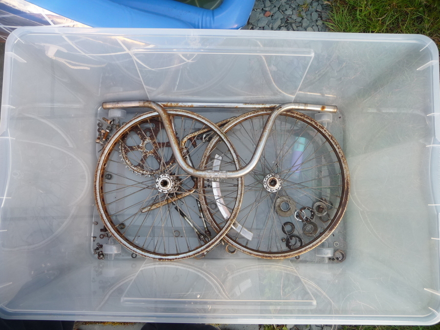

Into the big tub for the non-alloy parts.........
Loads of vinegar to be added ! :crazy2:

frame is looking good   :daumenhoch:
« Last Edit: May 21, 2010, 02:50 PM by rodgy »

That frame looks the dogs dangly bits....whats is like close up ?

 :shocked: Frames come up well John  :daumenhoch:

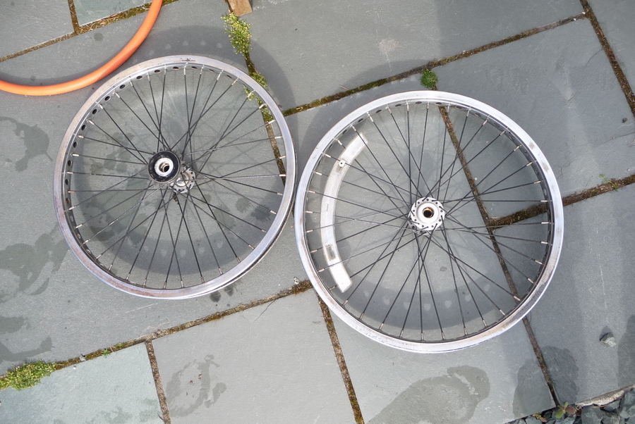

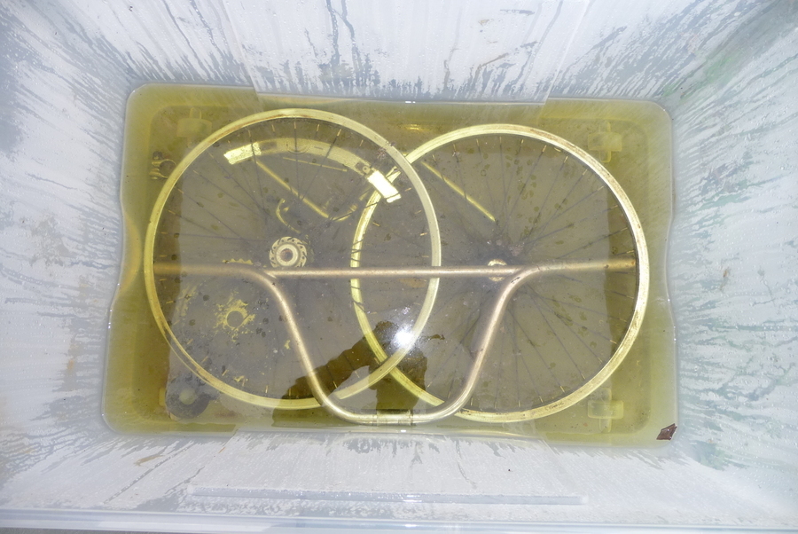

I decided vinegar or lemon juice would be too much of a waste to fill the tub so I used water mixed with citric acid powder that I got on ebay.
After 24 hours in the tub the rust was mostly just eaten away !
Before :
After :
OK so they're far from perfect but they'll do for this little cheapo survivor build  :angel:

It's a shame thought the rust has made a lot of holes in those rims.
Yeah mad isn't it - all exactly the same size and spacing  :LolLolLolLol:
