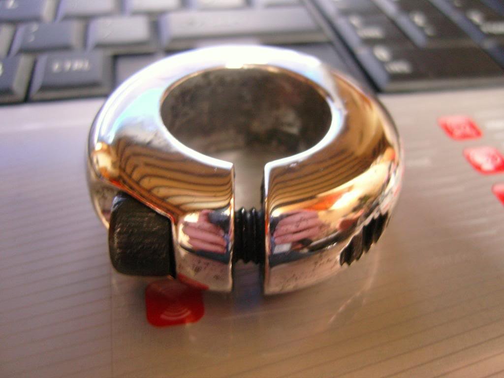

I got what i belive to be a hutch donut (came on that goose trickstar)
i have just polished it up - went to get a new bolt for it but ? it seem to be a different thread size cut into the clamp - i was going to use a m8 30mm new bolt
so was the bolt used on hutch stuff different to now ?
any one have a spare bolt for sale ?
any info boys ? please help
cheers B  ;)

Re: Hutch donut clamp ! info needed on bolt - see pic
« Reply #1 on: May 19, 2010, 06:36 PM »
possibily 5/16 UNC.
Offline HUTCHMAN
  • Posts: 2940
« Reply #2 on: May 19, 2010, 06:51 PM »
if my 5/16 UNC tap turns up from Snap On tomorrow,i'll try to remember to let you know.
« Reply #3 on: May 19, 2010, 07:00 PM »
Its deffo not Metric.....outside europe...no bugger uses it
I would say UNC is a safe bet as they were made in the US by US engineers.

« Reply #4 on: May 19, 2010, 07:07 PM »
a stem bolt would do it, like Dave said , 5/16 x 1" UNC

« Reply #5 on: May 19, 2010, 09:34 PM »
so it's deffo a 5/16 x1" that i need ?
any one have a hutch donut clamp ? and is it a gen 1 - which one did the stamp with a H and did they put Hutch on it - any info ?
cheers B  ;)
« Reply #6 on: May 19, 2010, 09:38 PM »
any hutch clamp with ANYTHING stamped into it is not US made... Hutch Hi Caliber,

« Reply #7 on: May 19, 2010, 09:49 PM »
9/16 UNC bud as far as I know . Had 2 get 1 4 one of mine  ;)

« Reply #8 on: May 19, 2010, 09:50 PM »
This one has nothing on it at all
i thought there were different shapes to them ?
« Reply #9 on: May 19, 2010, 09:56 PM »
could be wrong,but from the pics,yours looks like a full radius US made. what you reakon Glen?

« Reply #10 on: May 20, 2010, 01:16 AM »
5/16 or 9/16  ???
« Reply #11 on: May 20, 2010, 08:29 AM »
I'ts not 9/16, thats over 1/2 an inch.

« Reply #12 on: May 20, 2010, 10:37 AM »
http://cgi.ebay.co.uk/10-24-X-5-8-UNC-STAINLESS-ALLEN-HEAD-CAP-BOLTS-4-PCS-/150433930539?cmd=ViewItem&pt=UK_DIY_Material_Nails_Fixing_MJ&hash=item23068f9d2b
so link above is what i'm looking for - just want to get this right  ;)  (it's like trying to find the right size nut to go into tange clamps  ;D)
cheers B

« Reply #13 on: May 20, 2010, 10:39 AM »
That's not it at all, 5/16 x 1" UNC.

just to conform,i got my tap from Snap On today,i can confirm it is 5/16 unc. wound straight in. Not a bad price, £5.52.
