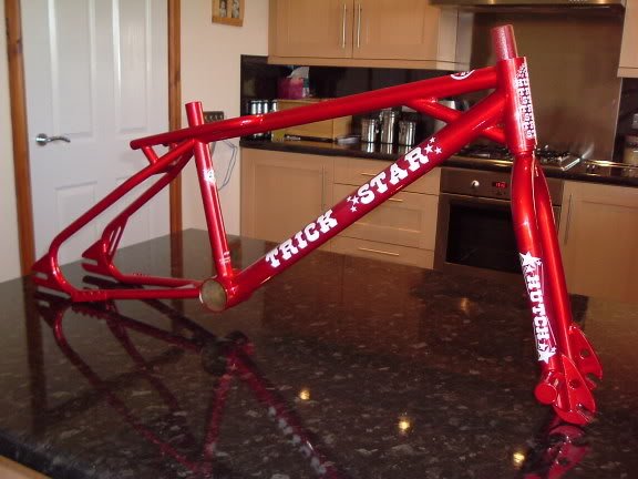

rad dad
Re: Decal application advice please
« Reply #11 on: April 16, 2006, 09:50 PM »
I for one never get tired of drooling over your gen 1 dave, i had one as a kid and sold it on to a cousin  :'(
anyway this is the finnished item, hope you like
Offline Rombloke
  • Posts: 77337
  • do one
« Reply #12 on: April 16, 2006, 10:05 PM »
bling!!!!!!

weston
« Reply #13 on: April 16, 2006, 10:09 PM »
lets see it built now :daumenhoch:
rad dad
« Reply #14 on: April 16, 2006, 10:22 PM »
Not sure wether im gonna build it up
makes a lovely ornament

Jazzchimp
« Reply #22 on: April 21, 2006, 08:53 PM »
you've got our kitchen!
Nice frame by the way.
