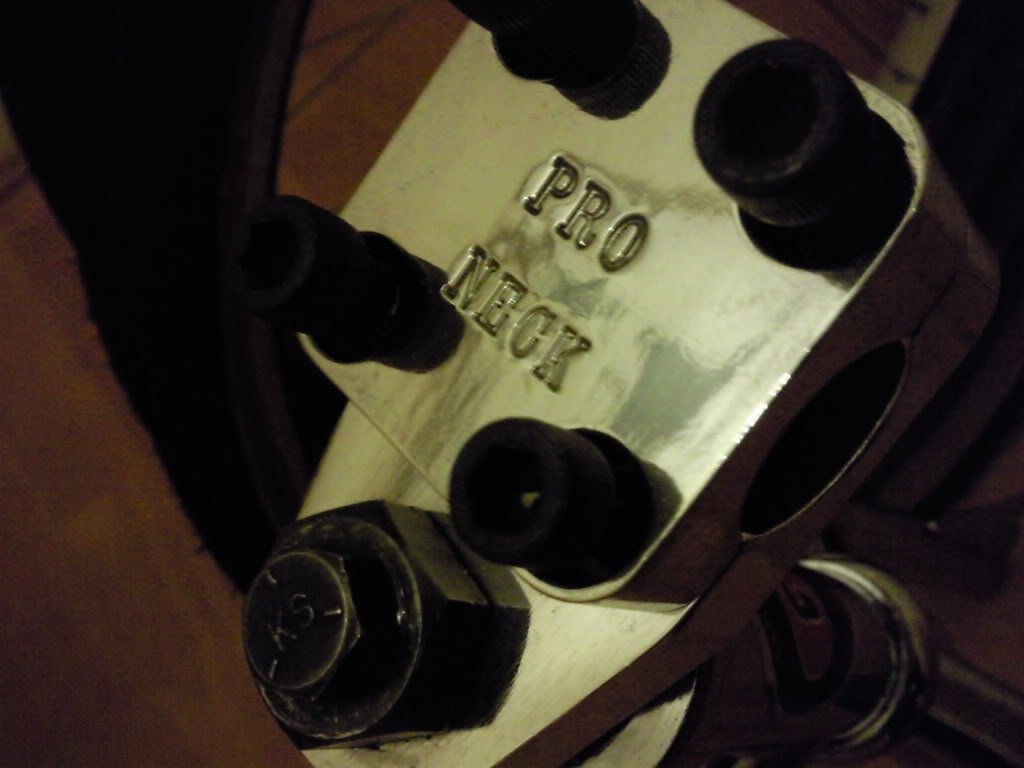

Got a really nice pro neck coming today which just needs it's orig white coat of paint stripped (it has already peeled) but the stem itself is immaculate and ding free.
What will be the best way to remove the white gently without messing the stem up?
I have the Autosol at the ready once the paint has been removed.
My first attempt at a resto so don't want to Balls it up.
Here's the Stem:
Cheers  ;)

nitromors paint stripper from halfords or most decent car shops. follow instructions on the tin. once stripped rinse, dry a little blob of autosol and jobs a gooden

nope,permatex gasket remover is the stuff,hard to get tho,others do work,powder is a bloody mare to remove
you can get nitromors in a spray can, its like gel/foam and ive had good results removing powder coat with it :daumenhoch:

Peeled a bit of white paint off as a test Marty and it has come up like a mirror  8)

the bile from an alien ell take it clean off Jas , hard to get hold of though , nitromors is the one , make sure its all washed off after though , left some pedals in the stuff and forgot about em , took what i wanted off but sent the metal black  :LolLolLolLol:

just put some on all over it , minutes to peel , clean off the peeled powder  then do again till all of the powder is off then give it a wash

Cheers the stem underneath the paint is immaculate and shone up lovely-so is the stem bolt and the allen bolts  :daumenhoch:

Coming up like a fookin Mirror-just going to finish the bottom-pics to follow Sunglasses may be needed  8) 8) 8) 8) 8) 8) 8) 8) 8) 8) 8) 8) 8) 8) 8) 8) 8) 8) 8) 8) 8)
sweetbeats
Few little spots need a bit more buffing but overall it has come up a treat  :smitten:
Thanks for the advice fellas  :coolsmiley:
