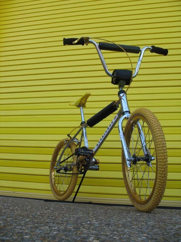

I HAD BEEN LOOKING FOR ONE OF THESE FOR OVER 6 YEARS AND HAS BEEN 16 MONTHS IN THE MAKING
BUT I HAD TO FIND ALL THE RIGHT PARTS TO BUILD IT AS CLOSE TO THE ORIGINAL BIKE AS THEY WERE BUILT BITD
I PICKED UP THE FRAME FORKS ETC FROM ONE OF THE GUYS THAT ORIGINALLY BUILT THEM,HE WAS GOING TO BUILD IT HIMSELF BUT GOSSA HOOKED ME UP WITH HIM AND HE DECIDED TO LET IT GO,THE FRAME HAD BEEN BADLY SAND BLASTED THEN CHROME PLATED :idiot2:BUT IF MUST HAVE LOOKED SO BAD IT WAS PAINTED SATIN BLACK,I STRIPPED PAINT THEN HAD CHROME REMOVED
AND THEN SPENT WELL OVER FOURTY HOURS SANDING AND POLISHING FRAME TO REMOVE ROUGH SAND BLAST FINISH BEING CAREFUL NOT TO REMOVE BRAIZED WELDS BEFORE RE CHROME,THEN I HAD BOTTOM BRACKET-HEADSET-RIMS-HUBS-CRANKS-RE ANNOD AS PER ORIGINAL FINISH.ONE OF THE ORIGINAL PARTS THAT WAS MISSING WAS THE S.J.K STEM AND THE CHANCES OF FINDING ONE WAS SLIM TO ZERO SO I DECIDED TO FABRICATE ONE,I ONLY HAD A SMALL PICTURE OF ONE TO WORK FROM,I USED CDS TUBE AND 3MM PLATE THEN I BRAIZED IT TOGETHER AS THEY WERE ORIGINALLY,THEN I HAD SOME ALLOY STEM TOPS MACHINED UP AND THEN SHAPED EDGES BY HAND,ONE OF THE BIGGEST CHALANGES WAS RE-CREATING THE DECALS AS WE ONLY HAD A FEW SMALL PICS TO WORK FROM BUT STEVE (FIREBIRD) STEPPED UP TO THE PLATE AND WORKED HIS MAGIC AND I WAS BLOWN AWAY BY THE RESULTS
BIG THANKS TO STEVE(FIREBIRD)FOR PADS AND DECALS
STIDDS FOR WHEEL BUILD  WEEKSEY FOR ANNO ON STEM
AND MASSIVE THANKS TO GOSSA FOR SORTING OUT THE PROJECT FOR ME ;)
FRAME AND FORKS-S.J.K CRO-MO
BARS-S.J.K
SEAT POST-S.J.K
BOTTOM BRACKET-S.J.K
HEADSET-S.J.K SEALED SYSTEM
STEM-S.J.K REPOP
TYRES-COMP II NOS
GRIPS-JOHAR RADGRIPS NOS
BRAKE DC 900 NOS
SEAT CLAMP-SUNTOUR NOS
SEAT-JAGUAR AERO NOS
RIMS-ARAYA RE ANNOD
HUBS-S.J.K SEALED RE ANNOD
CRANKS-SUNTOUR VX RE ANNOD
PEDALS-BM10s NOS
CHAINRING-SUNTOUR 44T NOS
WHEELNOTS-HOMEMADE AS PER ORIGINALS
