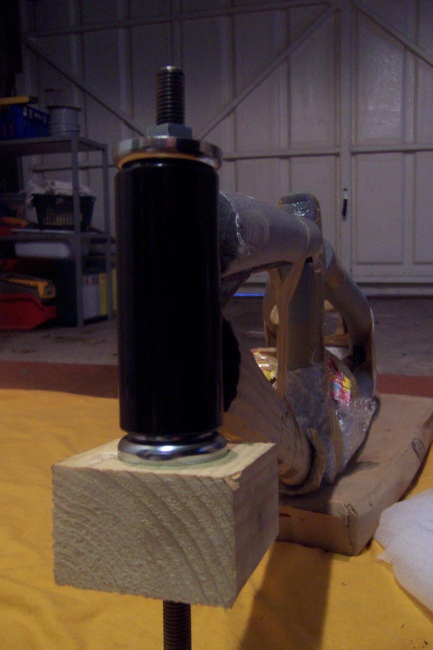

I made one, worked really well. Just tighten and tap, tighten and tap.
FuNMoNsTeR
Re: Hatta headset
« Reply #6 on: May 02, 2006, 07:55 PM »
Nice one m8...kool idea :daumenhoch:
