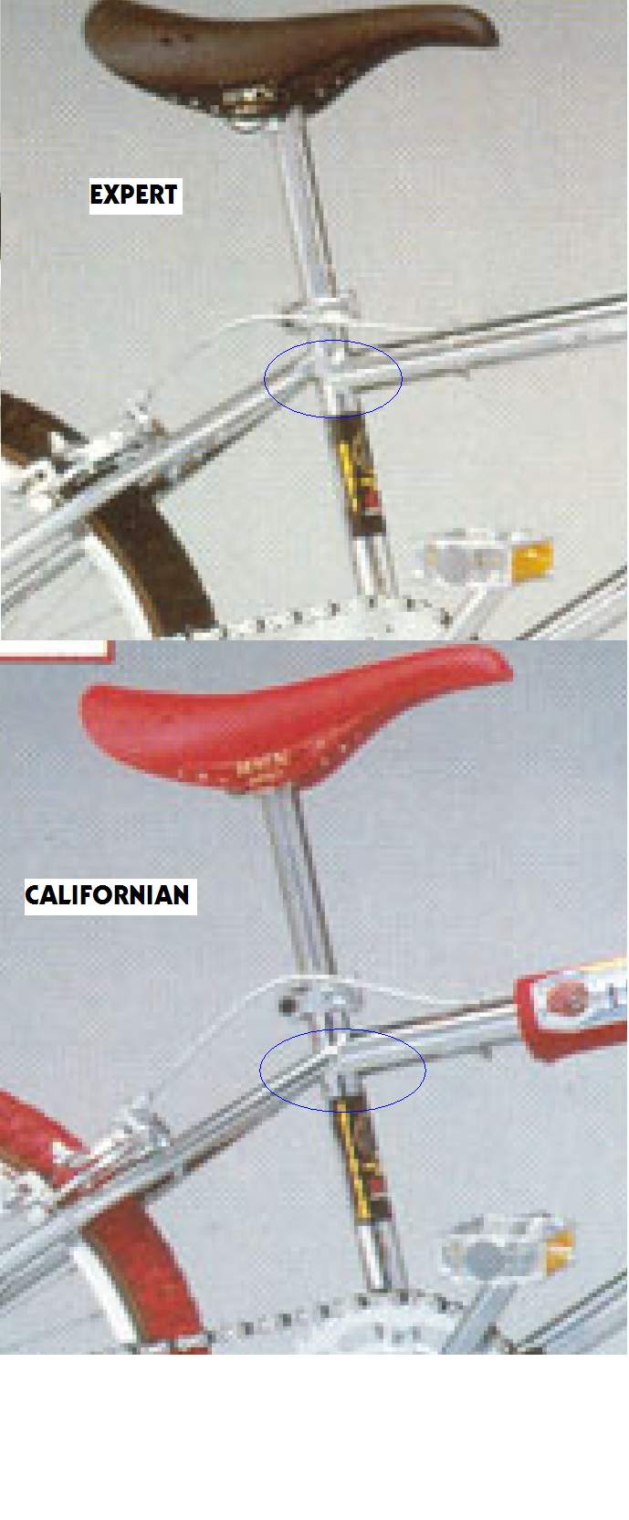

There is however a slight difference in the 2 frames when you study the official mongoose pics of the era.
The rear tubes on the expert meet the seat tube higher up and some use this as an identifier for an early expert .
However, when you factor into that the fact that the expert wasn't sold as a model in the UK and the fact that in the UK 83 catalogue the californian shown bares more resemblance to the frame style of the expert in the US catalogue and add further into the mix the "sticker them up and get them sold" mass production at the time and it's a mess !
