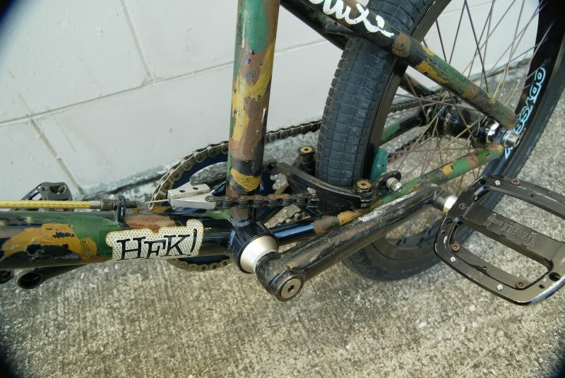

Well I didn't make it, a friend in the US did. He runs Zodiac Engineering.
http://zodiaceng.com/
It's basically similar shape to an old Fly hanger but with the option of spokes as well as a wire if I didn't like the feel as this is the first time I've run it. I now have a DT swiss straddle! Mine should have a grub screw in it to stop the cable but I dropped that and have had to temporarily replace it with a cap head which looks massive and ugly. Just imagine it's not there  :idiot2:
I was going to buy one of these but I don't like the bolt used...

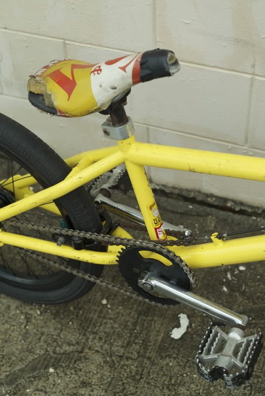

Oh and a chain straddle is the way to go if you are a real man....

I like your fly one, but Im not sure about the directon of the spokes. They dont "pivot" and you are bending the spokes when you pull the brake. Looks nice tho.
Those ones you were going to buy are totally what I was thinking of making, starting with a normal hanger and cutting off the folded bit. I wanted to use the spoke ends as a pivot. Really neat. I see what you mean about the ugly bolt but I could live with that. I esp like the smaller ones. Where can you get those from (although I might just make one). The only problem is that i have a fly brake and the stupid "bent arms" mean that the pinch bolts are an a different angle to the cable, so the pivot of the pinchbolts in the arm will be all on the piss. Its "OK" with cables but spokes wont bend as easy, so it might just lock up. i love fly brakes, but HATE the bent arms.
Finally, that chain stradle cable is amazing. Ive never seen that before, I LOVE it. I HAVE to do that one a bike now.

Hi all,
The fit in the straddle (Zodiac Eng, not Fly) is pretty good and the heads are countersunk allowing them to move. They don't need to move much you know as the pivot happens at the knarp end. I don't think they'll bind at all to be honest.
You can get the spoke straddles from Steven Webb on steven underscore cankles at hotmail dot com that was a few years ago mind. He's from Oz and I saw the pictures on bikeguide.
Small ones are for behind the seat tube and big ones for in front.
I'd make my own personally with a grub screw and a similar design if I were you.
The spoke mod in mine was a surprise so I thought I'd try it out but have been thinking about it for ages.
Wow, I let the cat out of the bag with the chain straddle huh?
I'm working on one right now myself to go on my Progression.
Here's another...a Frankenbraker model

Oh if you like light/custom stuff, look closely at the first pic and you can check out my custom Titanium and alloy barrel adjuster for the cable tension! :daumenhoch:

OK just thought about my straddle again.
The hanger has up and down float for the spokes and the knarp end has side to side float for the spokes. Hope that makes sense, but that's why it's done this way to stop binding.

Im even wondering if I'd be able to straighten the arms on my fly brake (using heat and a vice) so the spoke movement/knarp pivot was parallel with the arm movemet.
I think you are asking for a snapped arm personally if you do that. Maybe if they were forged but they are CNC'd so will be cut across the metal grain boundaries anyway. I'd sell it and by the correct one if I were you.
There is a seat stay, chain stay and front Fly brakes all with different angles.
Also I think Diacompe do an extremely similar one now for less.
