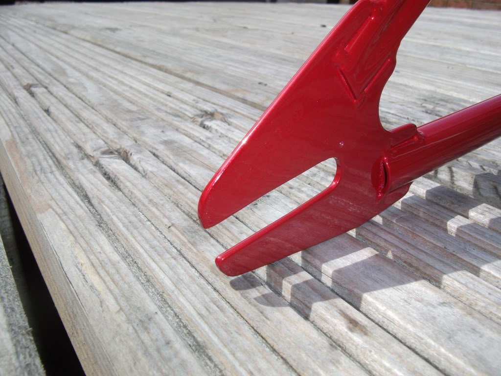

got this and it was butchered was passed on by about 4 people when they saw the work needed so here goes the start of a long job
so out came the grinder on the doner frame   ;)
the forks that some numpty had groung down to take 14mm axles :shock:
the bits groung out of some other raleigh forks  :oops: and placed in the big holes  8) ready for welding
now the same with the rear drop outs
this is going to take some time so i will keep you updated
stage 2 the welding by me   8) able to save the serial number as well
apart from the No4  :'(
just need to file the tange design fork ends now for the little alloy top hat washer :cool:
A couple of finished pics

« Reply #5 on: June 07, 2011, 06:56 PM »
update chaps thought i would pop into work today and paint this

Nice bit of welding and the dressing off was well done also, is the candy a single pack system bud?
yes mate its a lexus colour candy red over a white base coat   think its barcelona red  ;)

Time and effort well spent there Mark. The attention to detail, filing out the fork drops for a top hat, is amazing and looks the dogs  :daumenhoch:
