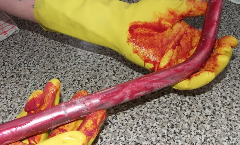

its a gooey liquid
heres Snav in action in one of my fav pics from RADBMX  ^"^

« Reply #19 on: February 15, 2011, 02:28 PM »
its a gooey liquid
I had that problem 'arise' with an ex-girlfriend - I accidently banjo-stringed meself - ooof  :-[
