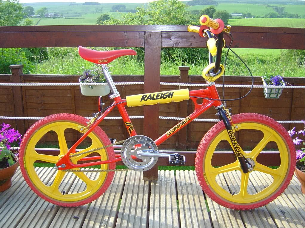

One of my post's from Burnerworld
the gorden ramsay way of dying wheels
take 1 set of OGK's - slightly faded
wash
pick out any dirty bits missed
scrape off any brake marks
bleach
hot water
salt
dye
put in and leave for 24 hours - turning and stiring every so often
cover
take out and wash in cold water - then dry
now ready to serve - i mean ride - DONE (camera changes colour a bit)
cheers B
