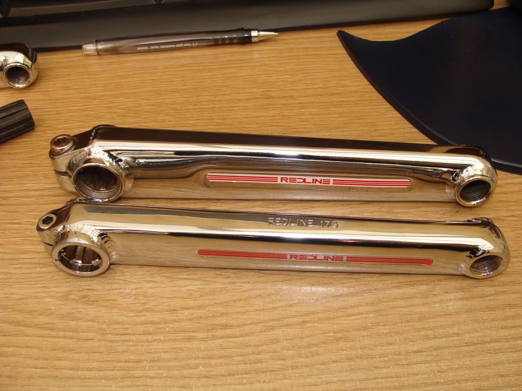

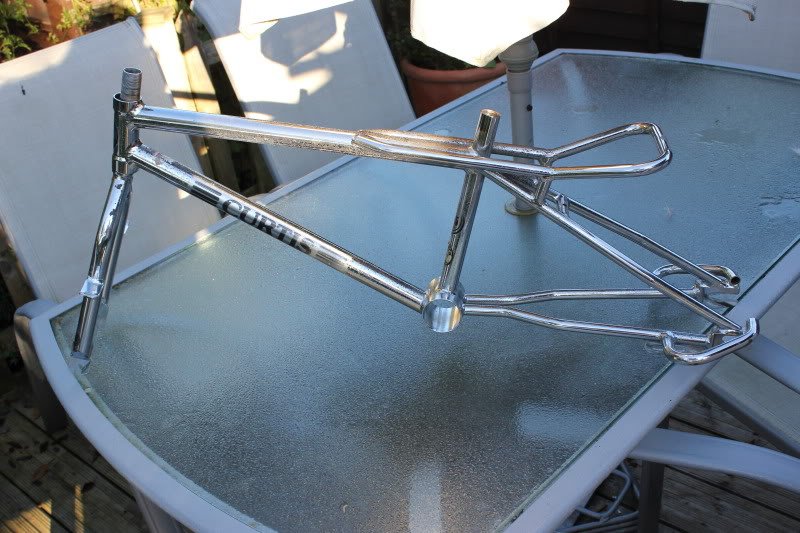

should work a treat ,i'v used it but didn't note down the ratio aswell
heres some results
Re: Oxalic Acid Powder to remove rust - what ratio/how long?
« Reply #9 on: July 09, 2011, 08:55 PM »
that looks good the gay pensioner! somehow I don't think my results will be as good (some of the chrome looks a bit shot tbh) but I'll see how it goes
