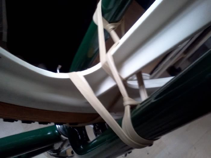

have used laggy bands in the past like this,  one from each side means you can centre the wheel between forks/stays leave sat for a few days , can only do one bend at a time ,  wooden doughnut press is the best method for a wobbler though  :daumenhoch:

ukoldschool
Re: Tuff 2 unbuckle?
« Reply #6 on: May 27, 2011, 10:16 AM »
oooh thats a good idea..... hmmmmmm  :D
« Reply #7 on: May 27, 2011, 10:18 AM »
Yeah  that pee's on the 'wedge a block of wood in there' method  :daumenhoch:
