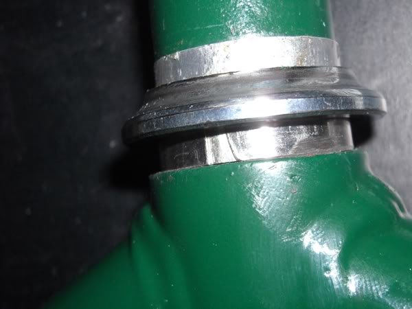

Bugger!!  This did not seem to be my problem as there is nothing to remove, indeed, I need to add metal to stop the racer from moving:
Shows small amount of play at bottom:
Shows small amount of play at top:
Racer sits all the way down to the main ridge.
So, I have tried Racers from two headset and, two different sets of forks with all combinations having the same problem with a small amount of play.  Also, when I stripped my Firebird for chroming, I dont recal having to use any force to get the racer off so I expect this play was always there..

Shim this bit all the way round:
 use a cut up Coke can (or soft/booze drink can of your choice), and cut a strip off from AROUND the can, not vertically on it. Cut to length so it fits all around the fork (or length needed to secure it), slide the race over, tap on and you're away :)
« Last Edit: July 10, 2011, 09:30 PM by dannywhac »

this was a more extreme example but sure you'll get the idea you can get race seats in different sizes but a shim is easyer use beer/coke tins or soup tins or similar to get thicker shims, pack it out so that  you to have to force the bearing seat on the crown to eliminate the play if you dont the head set will crack or you will damage the crown on the forks, these ones were ready to be tapped down to secure the race seat

I was reading "shim" as removing girth from the forks and clearly, I need to add girth to my forks.  So, I use a coke can to add girth!  Nice..  I have done this before with a seat post so, cool...

I did the coke can think and works fab!!  I put some folds in the can to ensure the can says in place, as shown:
Finally, with it all assembled and clamped down, pretty much invisible:
Huge thanks to all that helped out!!
