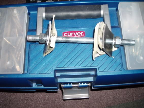

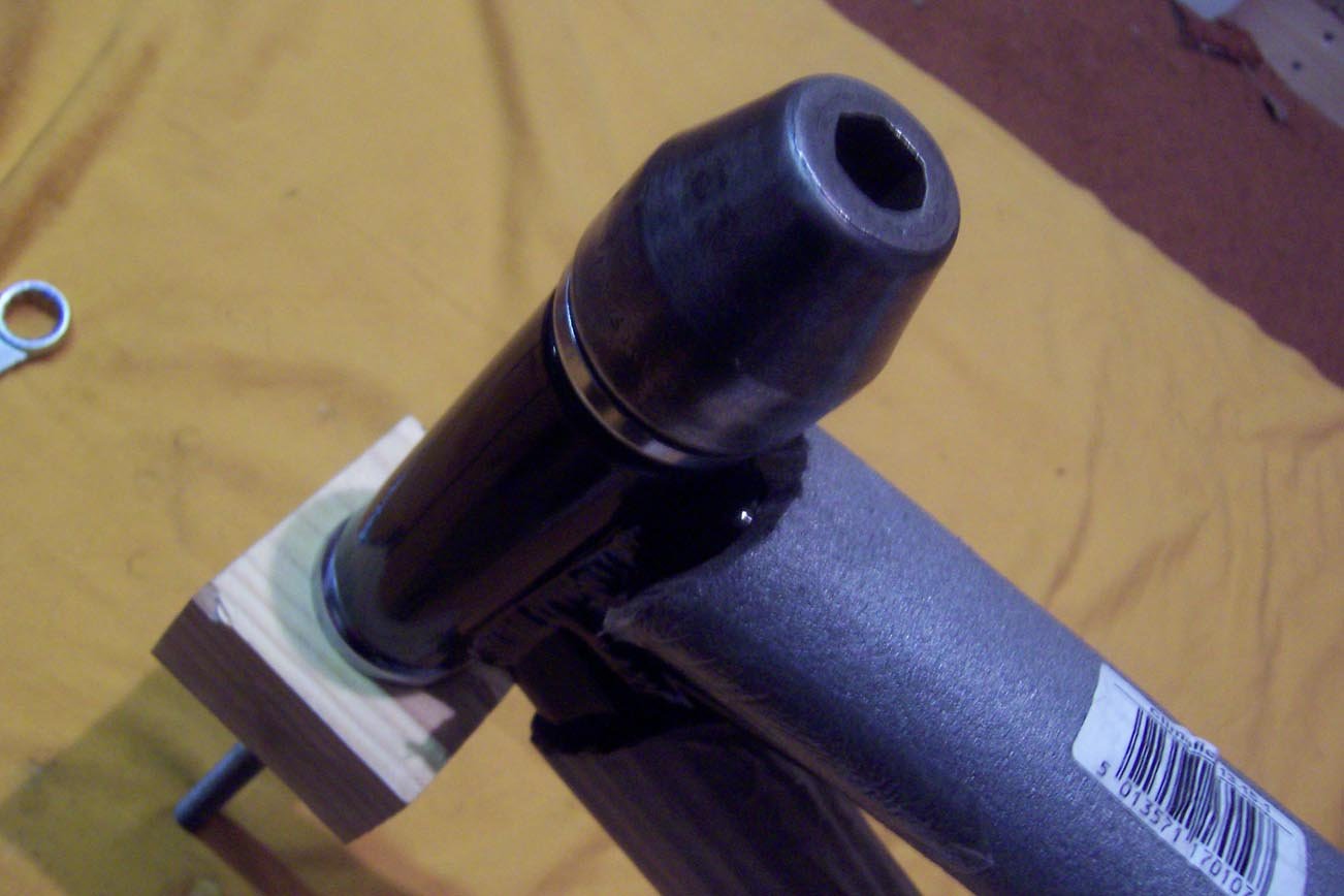

to save hammering the cups in damaging things ,get large nut bolt and washers they will do both aplications
cheep and easy just align cups and tighten. hope this helps.

make sure you have a thick strong bolt
T'is the only way unless you can afford posh bike tools
though i did fit a BB with a work mate bench and some scrap wood once
cheers Kev

i hammer headset cups in with no damage to them
BB cups are easier

They are quite useful, but I've now decided that the easiest way is with a vice (don't forget the soft jaws to prevent marking your beautiful NOS headset)

always found using a vice with wooden plates was the most effective way. equal pressure applied to the cups so they go in nice n square with a little grease to help them on their way.
