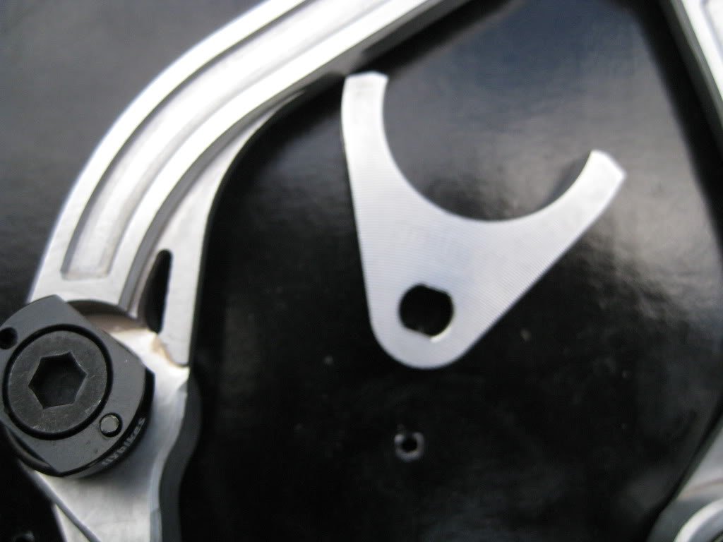

Oven Pride, followed by Peek, followed by Fairy Washing Up Liquid followed by Peek. :daumenhoch:
Even kept the "FlyBikes" Logo intact on every part!  :smitten:
Before (yuk):
After (hmmmmm):
