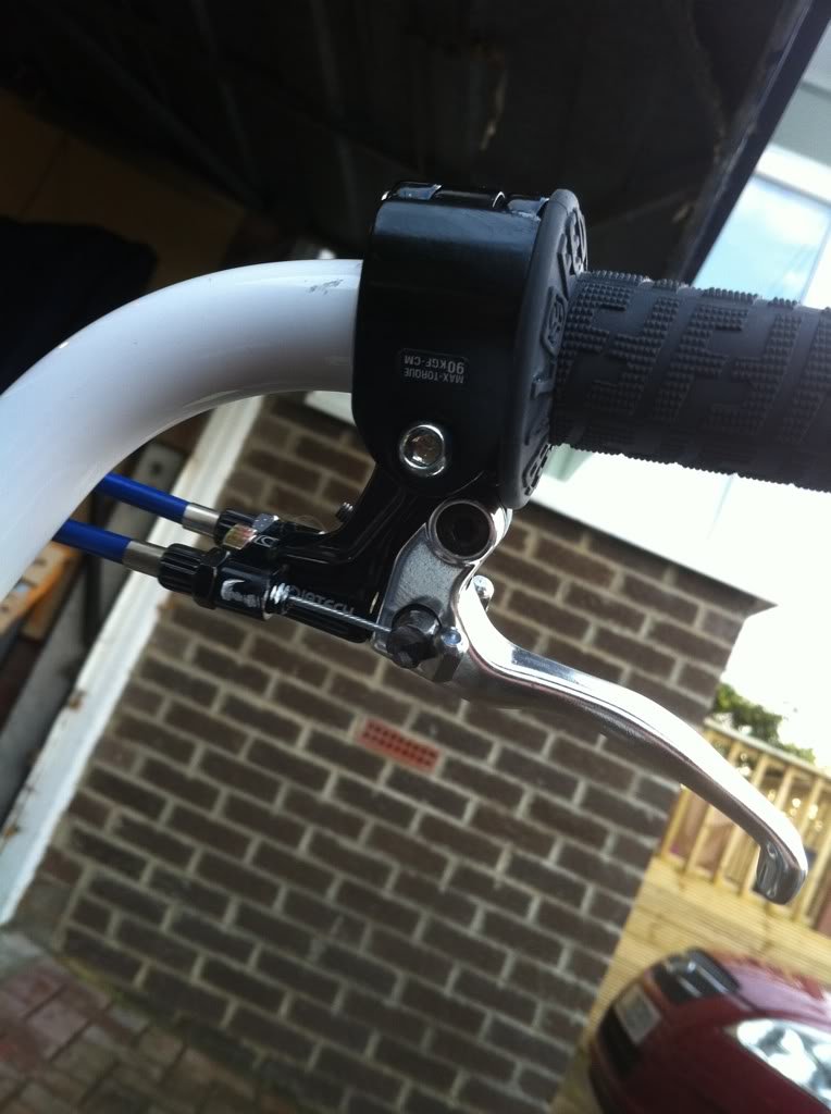

 :LolLolLolLol: peter, I run a gyro lower but I've got a diatech tech 77 lever with a mod that allows me to run two separate cables for the upper bit.
Any piccies
I want to get one of these "witch craft" gyro thingy's.................and I've seen some with two cables coming out of the lever and just wondered whats the advantage or is it just a "fashion" thing.......and as I'm soooooooooooooo down with the kids I didnt want to look even more or a twunt  :crazy2:

I think Odyssey do a lever as well that takes the dragonfly double top cable, I've not seen another one of the one I've got..........I'm sure I've got a pic somewhere.

Is there a mechanical or liner pull advantage to running two cables as appose to the 1 into 2 oddy cables ?

its a little smother and allows the springs to return a little easier so you could run less tension, easier to set up and maintain,
no real linear pull advantage though,

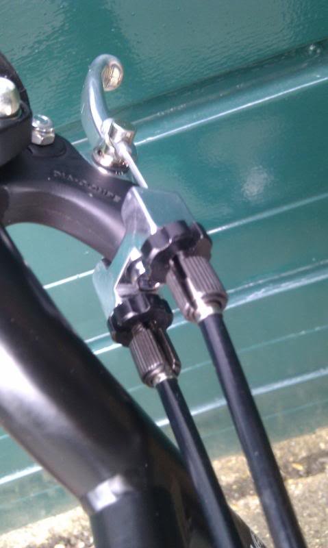

Pickle sent me some pics of his lever mod, it's really nice but sold out so I thought I'd make one.
Self explanatory really, a modified london mod, odyssey knarps and a bit of rod from b&q cut, drilled and 2 flats ground on it.
Works a treat and does away with the need for special cables.
