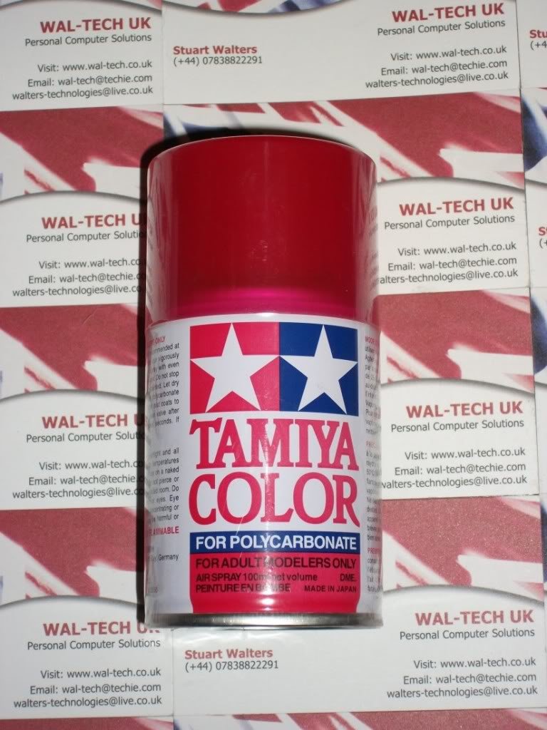

Whats the best paint to use on pedals etc to get the annodised look as on shimano dx peds??
Stodgy
BMX Overlord
Posts: 15931
Re: translucent paint
September 07, 2011, 04:45 PM »
Tamiya Model Car Spray Paint.
Perfect.
www.radbmxshop.co.uk
ultrasham241
September 07, 2011, 04:56 PM »
I have seen that, Is it o.k on alloy as it says `for polycarbonate ` ??. does it last o.k??

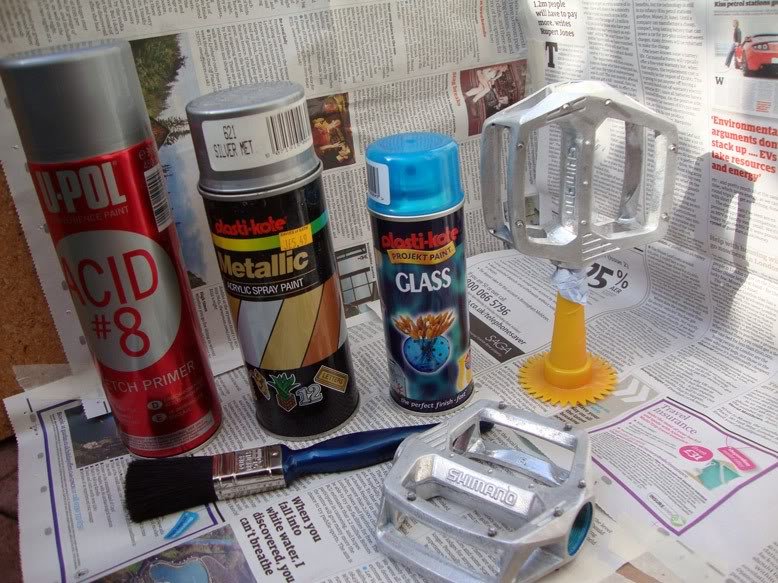

I used this and it seems Ok.
Don't know how long it would last but a coat of lacquer on top might help.
ultrasham241
Reply #5 on:
September 07, 2011, 07:20 PM »
Cool, where did you get the glass paint from?
sid1972
Reply #6 on:
September 07, 2011, 08:05 PM »
its getting rare...
http://www.paintsprays.co.uk/catalog/glass-paint-p-246.html
