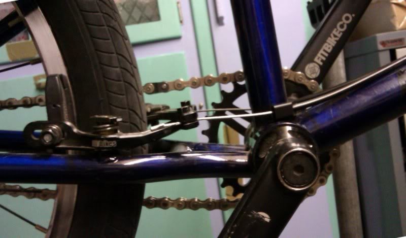

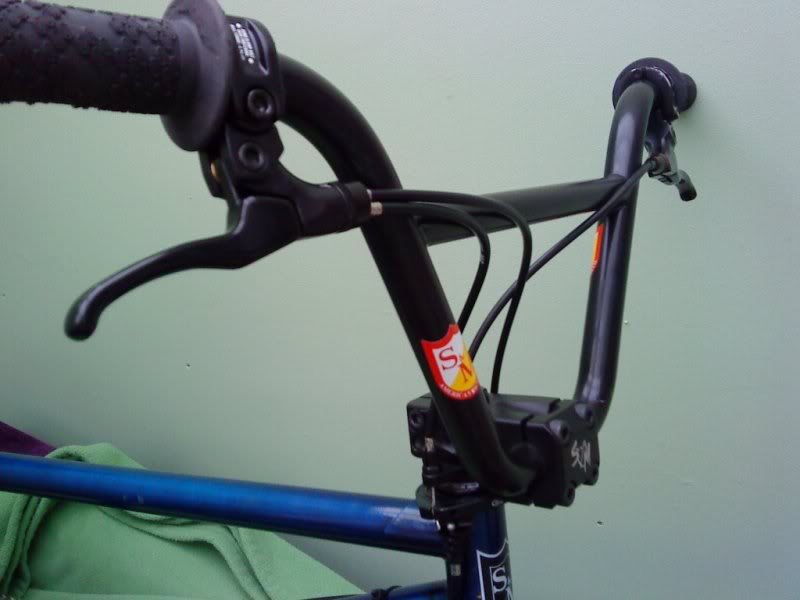

Ive been working on this for a while but Ive finally got a gyro on my bike. Thought Id post up a few pics of it, and say a few words about how its set up.
Ive not used a gyro for a while but I think it looks way better (neater) than a flappy straight cable. I also think it works better cos there is less cable stretch. I might even say that the reason I put one on, cos I don’t really spin the bars very often!
I don’t like the the 2to1 cable thing. It doesn’t sit nice, its ugly, and has more friction (and it bottoms out if its not set right). Twin cables from the lever is a bit bulky but the oddy twin lever is OK. It doesn’t have any of the cable ferrel hanging out and its also my lever of choice. I cut the barrels off the end and gave the cable loads of lube. It runs really nice.
Bolt on gyro tabs (with the adjuster cut down) and Redneck specific top plate. The gyro has pinch bolts built in, but I “tinned” the inner cable so it didn’t fray when you clamp it down
I wanted to run twin cables on the lower end. The 2to1 isnt nice, it doesn’t sit well against the frame, and it always seems silly to have a cable that goes from 2, to one, and then back to 2. I made a cable stop using bolt on gyro tabs and adjusters but I didn’t like it. It was bulky and the cables stuck out too much. I didn’t even use the adjusters
So I made a simpler one. Much cleaner, cables run nicer, and its also angled so the inner meets with the brake at a better angle.
I don’t really like the angled fly brake arms but its not to bad, the cable alighnment is pretty good, and the fly brakes work (and look) so good.

nice little mod there :daumenhoch:
i never used to run a gyro but decided to try em again awhile ago, i run a oddy twin cable lever, redneck top plate, snafu gyro and twin lower cables, oiled em before fitting and not had to touch em since (8 months now) best brake set up ive ever had :daumenhoch: :daumenhoch: :daumenhoch:

nice mod that alex,
is that a grub screw over the seat tube brake hole? does that hold the plate in place or is it just held with tension?
I put a tapped hole in the cable stop and bolted it to the seat tube from the inside. There is a big hole on the back of the seat tube (so the head of the bolt goes tho) and a small hole on the front. perfect.
On the Mk1 Design i tapped a blind hole, so no fixing would be seen at all but there were only about 2 threads and it came loose. On the Mk2 i tapped it right tho. I can live with the end of the bolt showing if it'll stay tight now.

So as and when you do want to adjust your brake Al, you can do a bit at the lever but any more and you'll have to pull the cables through the Fly?

Top tip on the tinning of the cable ends.  I fitted a new upper cable to my gyro at the weekend, and did that.
Well worth doing too, as it was the fraying of the ends that did for the old cable.
I always leave some adjustment on the lever. I seem to adjust it often, depending on how im feeling that day. I like the blocks to hit the rim when the lever is Almost crushing my knuckles, and some days i need to back of a bit (once they are bleeding! haha).
Cables these days seem great, i dont need to do much major adjustment at all. I had to mess about a bit to get the blocks hitting the rim at the same time (trial and error on the brake pinchbolt) but they dont have to be perfect cos the gyro itself will iron out any slight offset.
